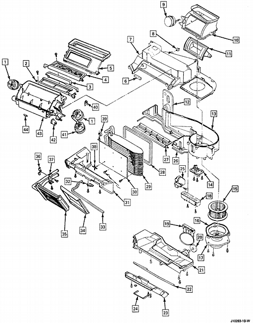

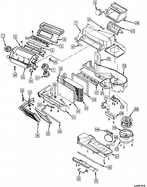

              I believe...the air intake from inside the car is behind and up from the glove box. But, your outside air intake, which is where is should be drawing first is a screened over (or should be) vent by the passenger side wipers. Do you have electronic HVAC or manual?

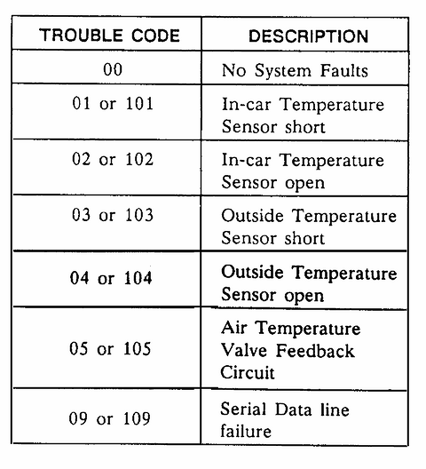

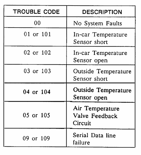

              ON-BOARD DIAGNOSTIC MODE
              air conditioning is equipped with an on-board diagnostic feature which allows the Heater And A/C Control Assembly to detect certain system faults. The diagnostic feature can also be used to display certain data parameters. If the Heater And A/C Control Assembly detects a fault in the system, the C0 or F0 annunciator will flash during the first two minutes of vehicle operation.
              Entry into the diagnostic mode is gained by depressing the "OUTS TEMP" and BI-LEV buttons at the same time. Once the diagnostic mode is entered, any trouble codes stored will be displayed. If none are present, 00 will be displayed.
              If the WARM button is depressed after the trouble codes have been displayed, the data mode will be entered. The information available in the data mode is displayed in units used by the computer which may not be of use in observing the system. To exit the diagnostic mode, press any mode button.
              Refer to the illustration for a list of the Trouble Codes and their meanings.
              NOTE: A two digit trouble code indicates the fault is present now. A three digit trouble code indicates an intermittent fault.
              This will work if you have electronic HVAC.

                OH YA! #'s 10 and 11 are air intake
