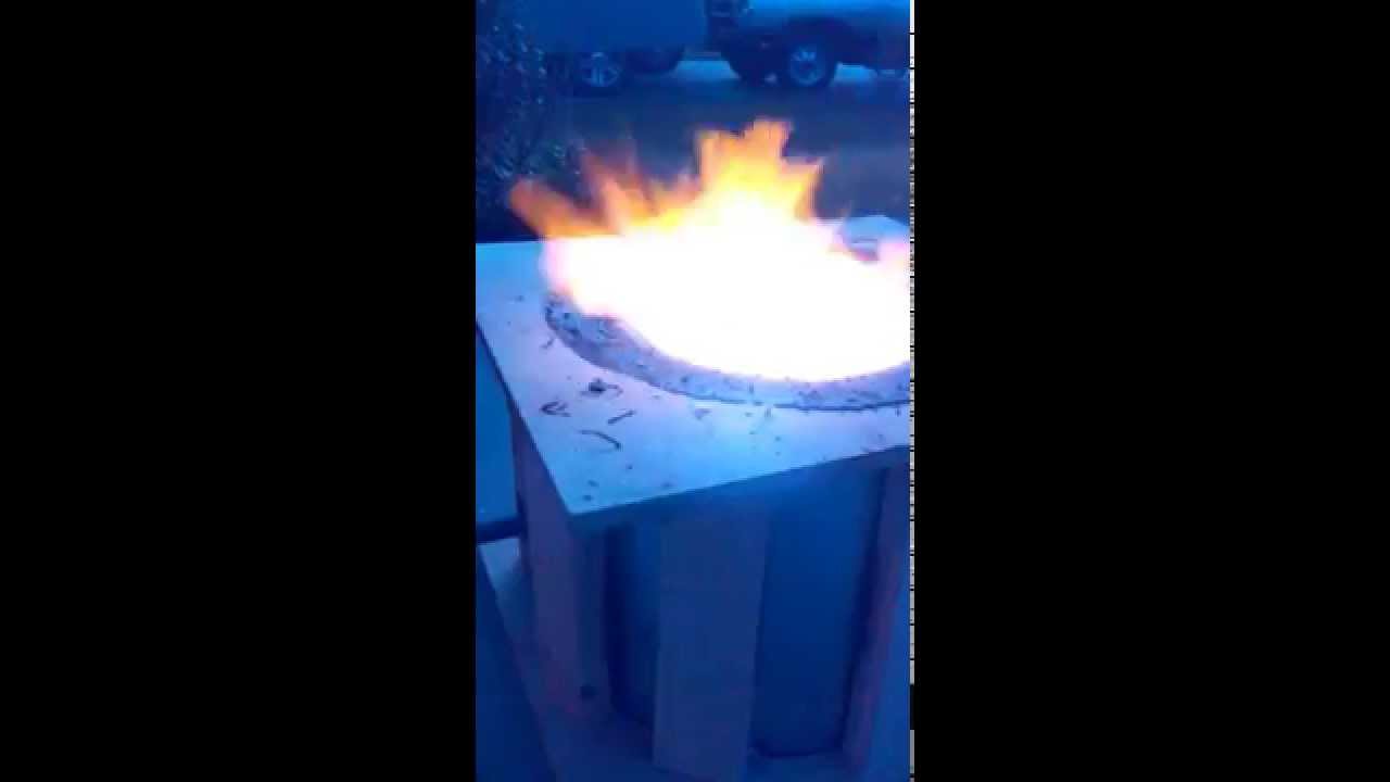

              #36
              here's a couple of crappy videos, I still need to make a lid for my furnace.
              • ericjon262
                build it.
                • Jan 2010
                • 2218
