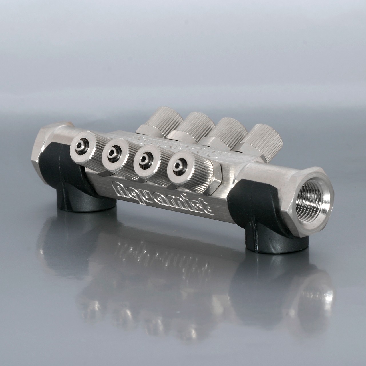

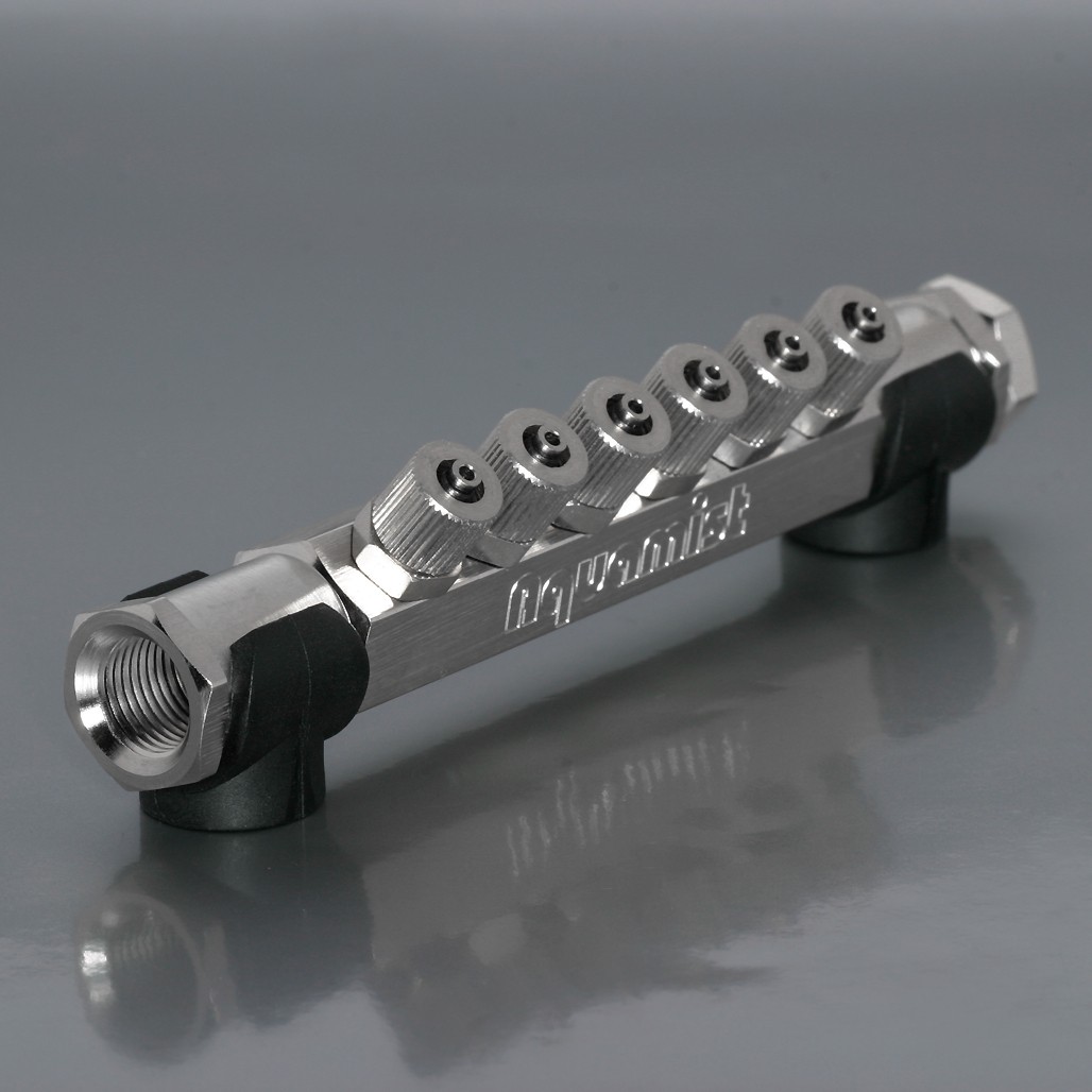

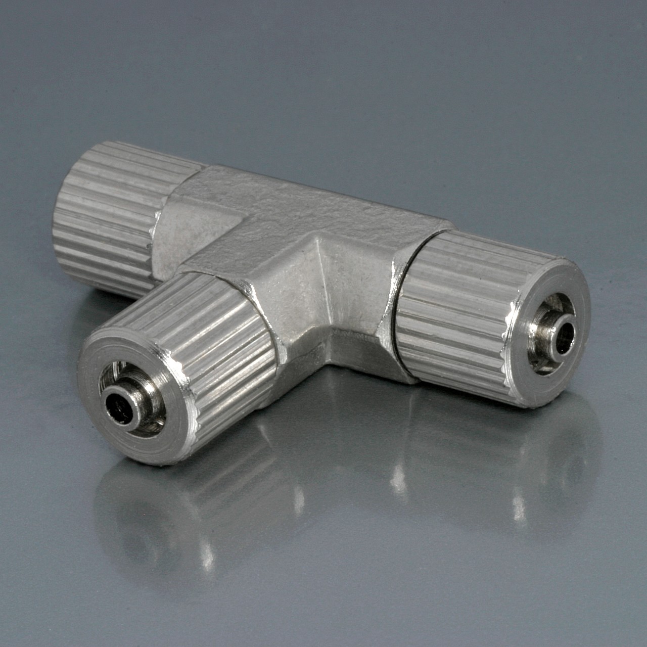

            Many thanks unchained, I was looking around and found Aquamist Injection systems. A bit pricey but wow they look nice. Noting they are the only PWM controlled injection system I can find.
            What I thought was slick is the distribution manifolds and fittings. It would make a really cool looking install.

            For a perfectionist, this is a nice product considering the accuracy of h20/meth injection ratio to fuel.
            I just might consider a home brew using some parts from Aquamist. Heck, I'd use those distribution manifolds as boost/vac port for other apps.
