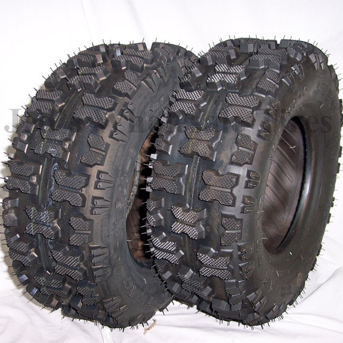

              thinking about tires again and i think i might stick with the size tire i got now but a way different tread. really isn't much to choose from besides the turf tires and snow blower tires. probably gonna pick this one up.

                #22
                lol, you'll probably see me over there in those threads. I'll see if i can find pics of my mini FM 40 for you.
                That tire looks mean, should do great offroad!

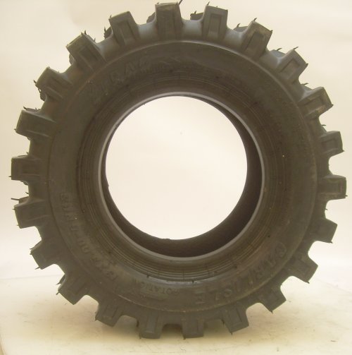

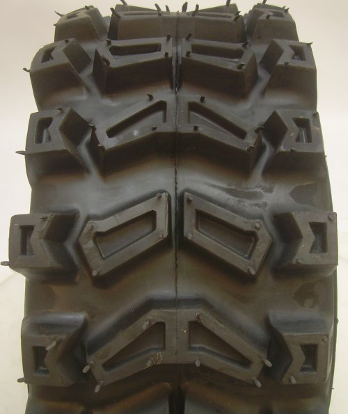

                  saw your thread on the balancer. just gotta remember where i put the flow 80 it's buried somewhere. lol don't remember if it was your screen name but i saw someone's custom FM 40 and the other guy who made a mini cherry bomb..
                  it's either that or the traditional snow blower tread. this one looks like it will still give a smooth ride on pavement. the turf tires for the riding mowers get caked up with crap and don't unload very well..the dirt just stays there
                  either the one i posted above or this tire..
