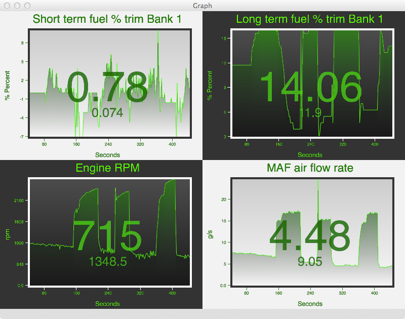

        here some datas from cold engine and misfiring.
        Best regards McLin.
