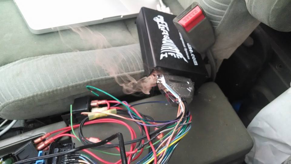

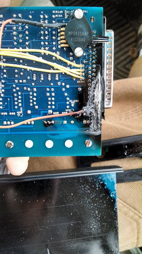

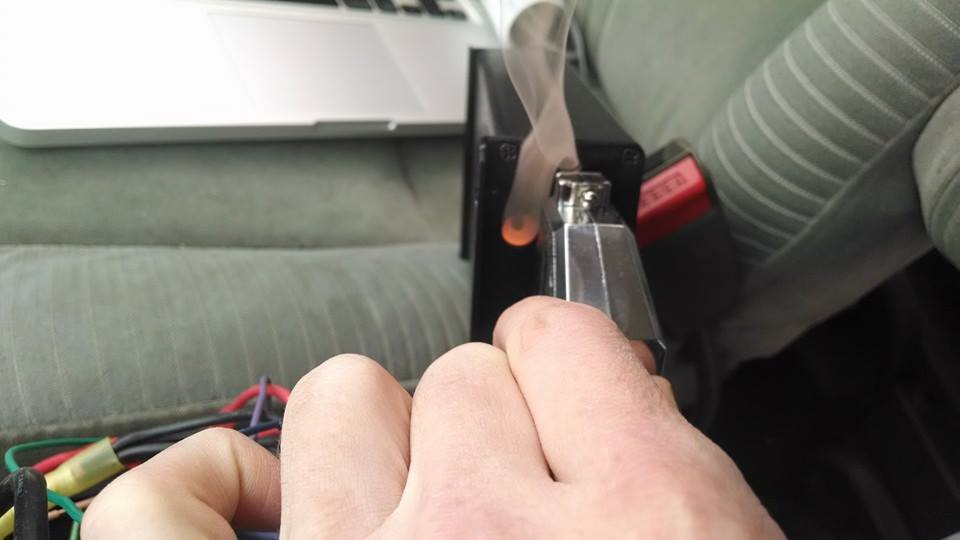

    I was going to have a mini-vacation soaking at a hot springs resort about 100 miles away, and I thought, I'LL DRIVE MY TROOPER! Trooper has MegaSquirt and that is a nice road to do some tuning on. And everything was working great. The hills were perfect for holding the engine at various loads to let the megasquirt auto-tune do it's thing. But then I started losing power. My megasquirt was on fire. First thing? Take a picture.

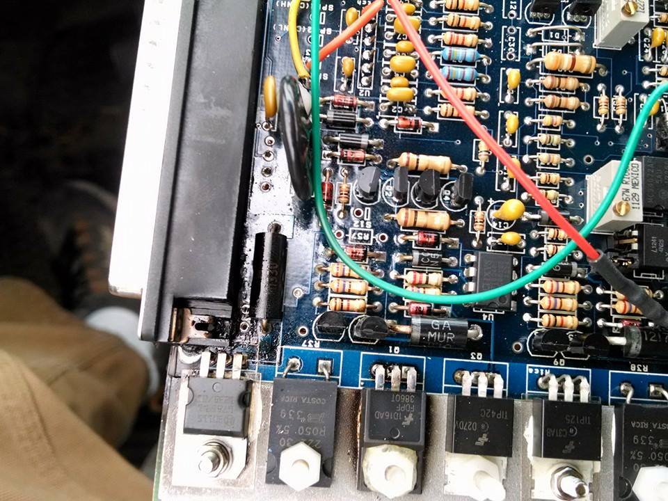

    Looks like an injector failed and over-currented the board in a catastrophic way.

                  Well, I figured out what the problem was. It was a combination of things. I had the MegaSquirt built to run low impedance injectors, but I had the PWM and current limiting settings in the software configured for high impedance injectors. So, too much current was running through the injector circuit. Combine that with the the stock wiring supplying injector power right off the main relay with no protection aside from the main fuse-link... That's a lot of current allowed (commanded through the incorrect software settings) to flow through the injector driver over an essentially un-fused circuit, hence the fire.
                  Had the software been set up correctly, everything should have worked fine.
