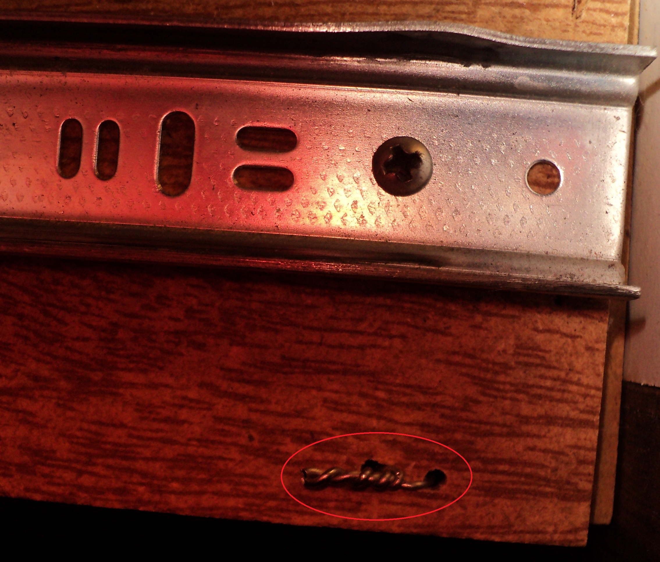

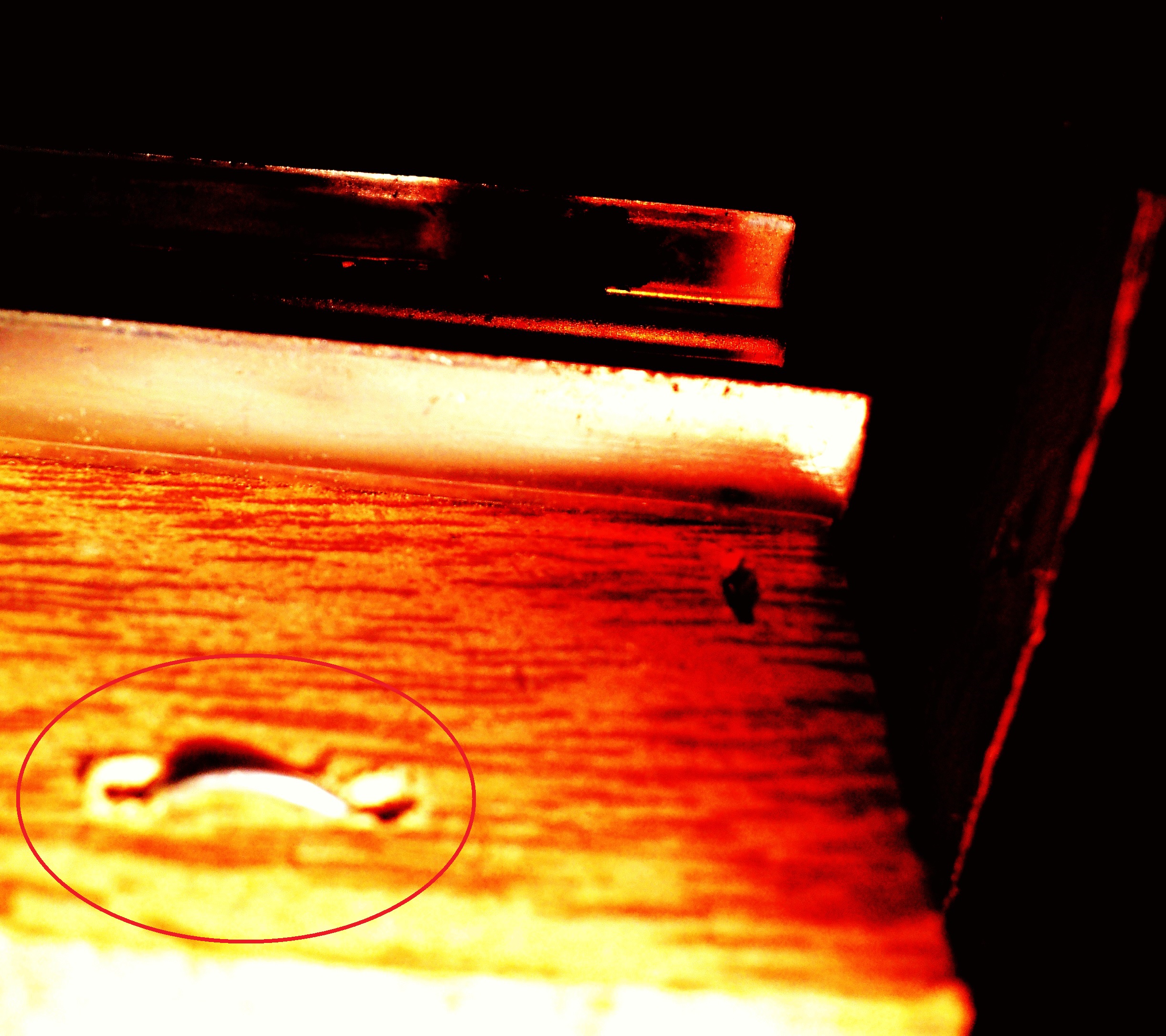

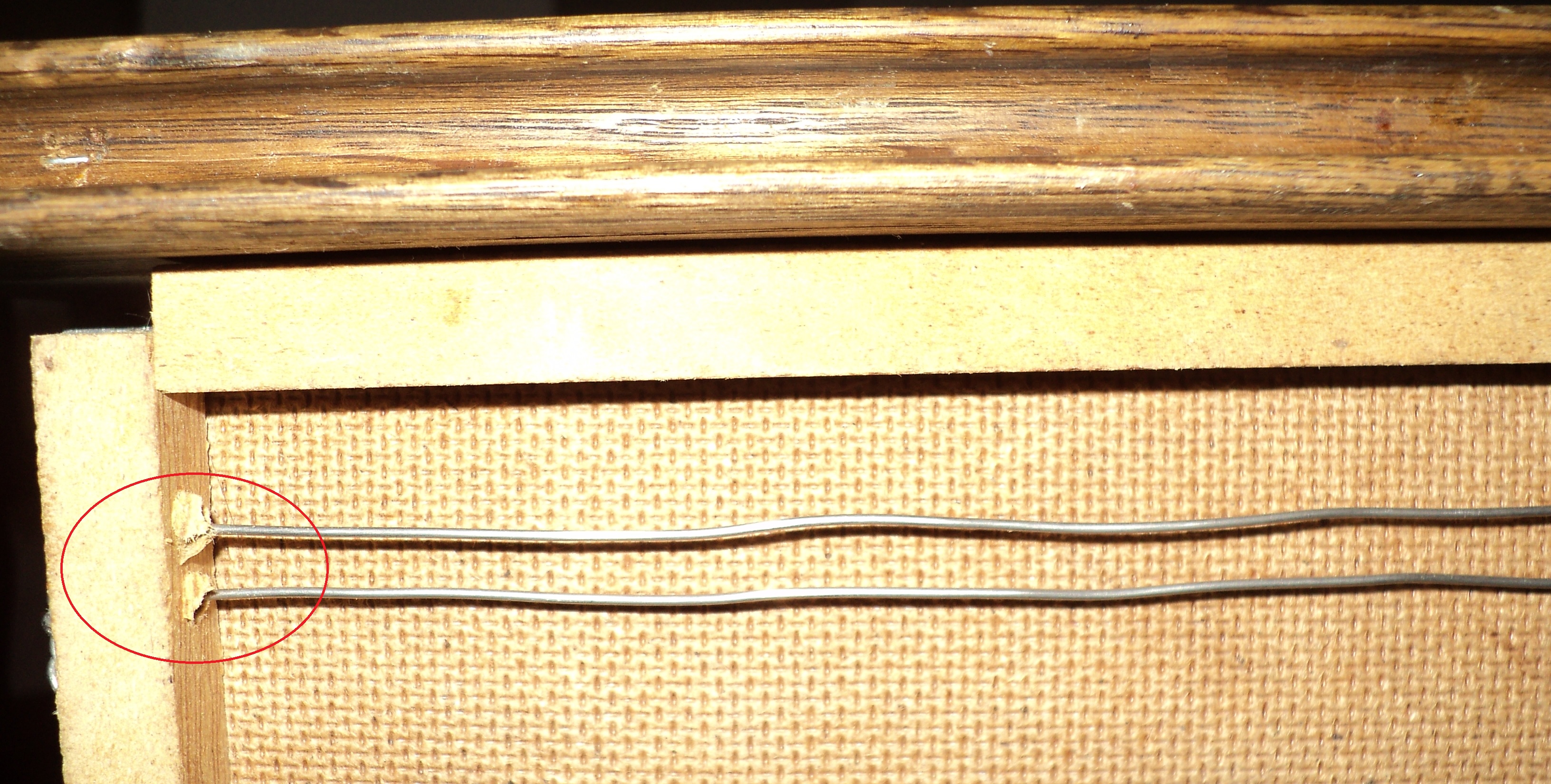

    I put the drawer segments back together by slipping the lower drawer “floor” panel back into the long side grooves of the long ends of the slotted side pieces that have the metal rail and rollers screwed onto each outer side. Then… I turned the drawer upside down and drilled out three pairs of 3/32” holes about 1/2” apart and located them just below the bottom edge of the slots near the front, the middle and the back of the two side boards. Then, using some Stainless Steel 0.041” Safety Wire (AKA Lock Wire from Harbor Freight) I measured out 3 lengths long enough to feed each of the two ends through each pair of holes, almost like a pair of shoe laces and then pushed the two loose lock wire ends through each pair of holes of the opposing side board.
    Then, using either a pair of flat nosed electrician's pliers or actual safety wire pliers… I slowly pulled the three pairs of “shoelace” wires tighter and tighter while twisting the two ends together keeping the drawer bottom panel snug inside the two side board grooves. It followed that, like tightening twisty ties, I just rotated the pliers gradually and watched the wires wind together on the outside of the side board until they were all as evenly tight as reasonably possible. Then I just clipped off the three ends and laid the coiled wire ends flat against the side boards.
    When finished, the 3 pairs of “Wire Shoelaces” were as tight as guitar strings and solved two problems: (1) The side boards can never get loose again… ever... and (2) The 3 pairs of wires give added “turnbuckle cable” like support to the underside of the drawer bottom, making it impossible for it to bow inward and slip out of the side panel grooves ever again! I slid the drawer back onto its rails and found out it “moves like a dream” ; even when loaded back up with a heavy bamboo cutlery tray along with 15 lbs of S/S knives/forks/spoons and all the other junk she has stuffed in there. I had this job done in 15 minutes without any assembly problems.

      It has been around three months since I tried out this strange woodworking fix... and it is still perfect in the outcome so I thought I would glom a few images of how it actually looks to offset the wordy description of how I did it:
