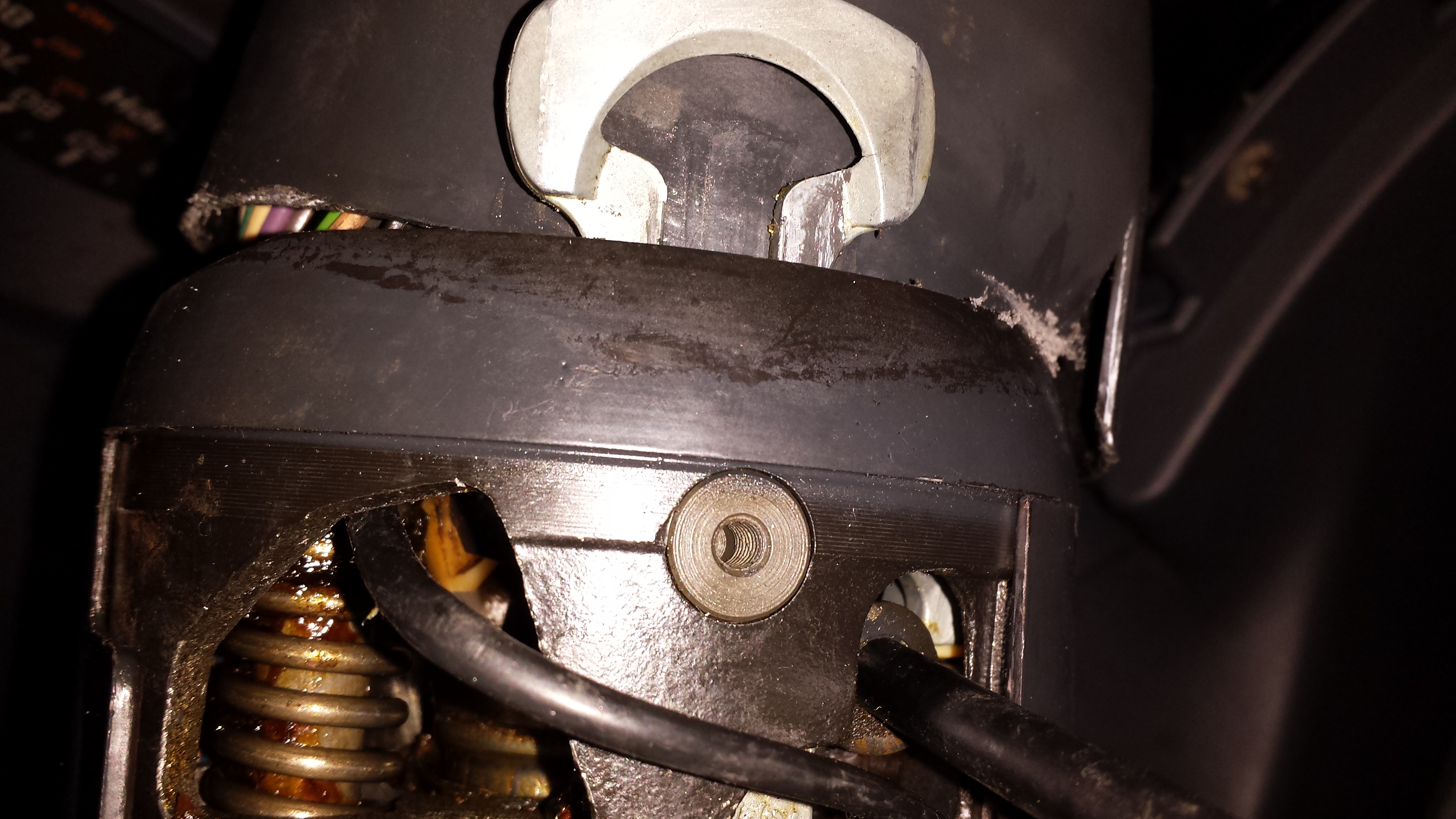

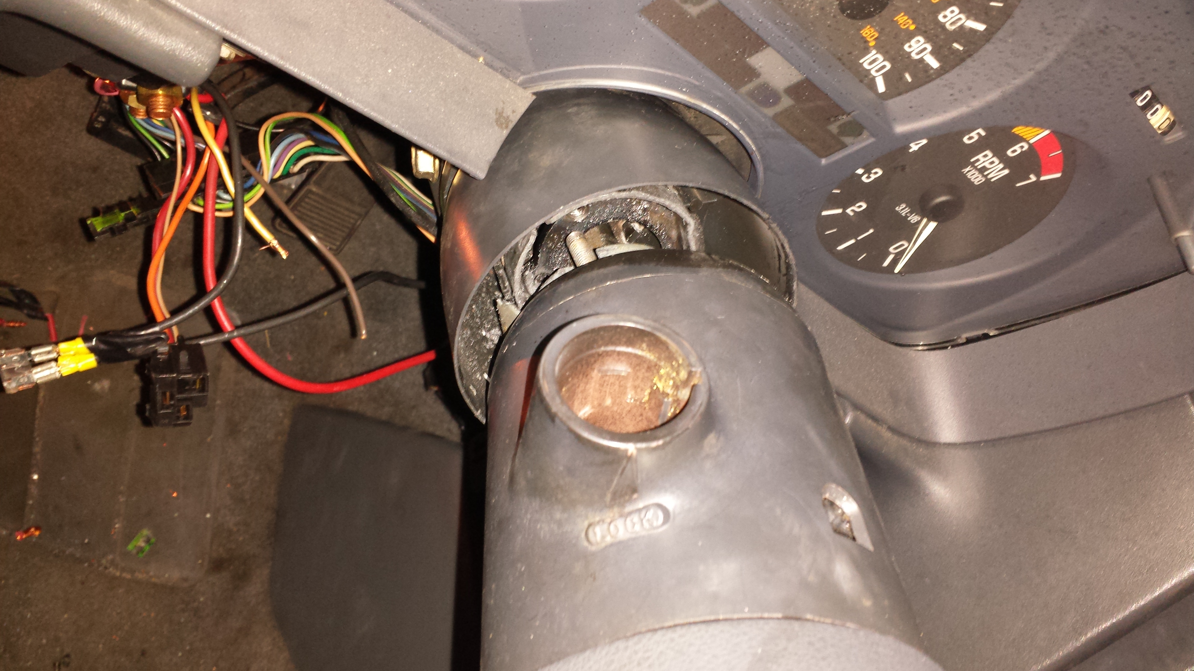

    I'm hoping to get this back together...how do you remove the covers on the steering column ? I have to tighten up the torque screws on the tilt steering and put it all back together...thanks!

    Heh... good ol Saginaw column... you have to take the whole damn thing apart to do anything with it.
    Have fun!
    Inside the GM tilt steering column
    Fiero (Saginaw) Steering Column Notes
