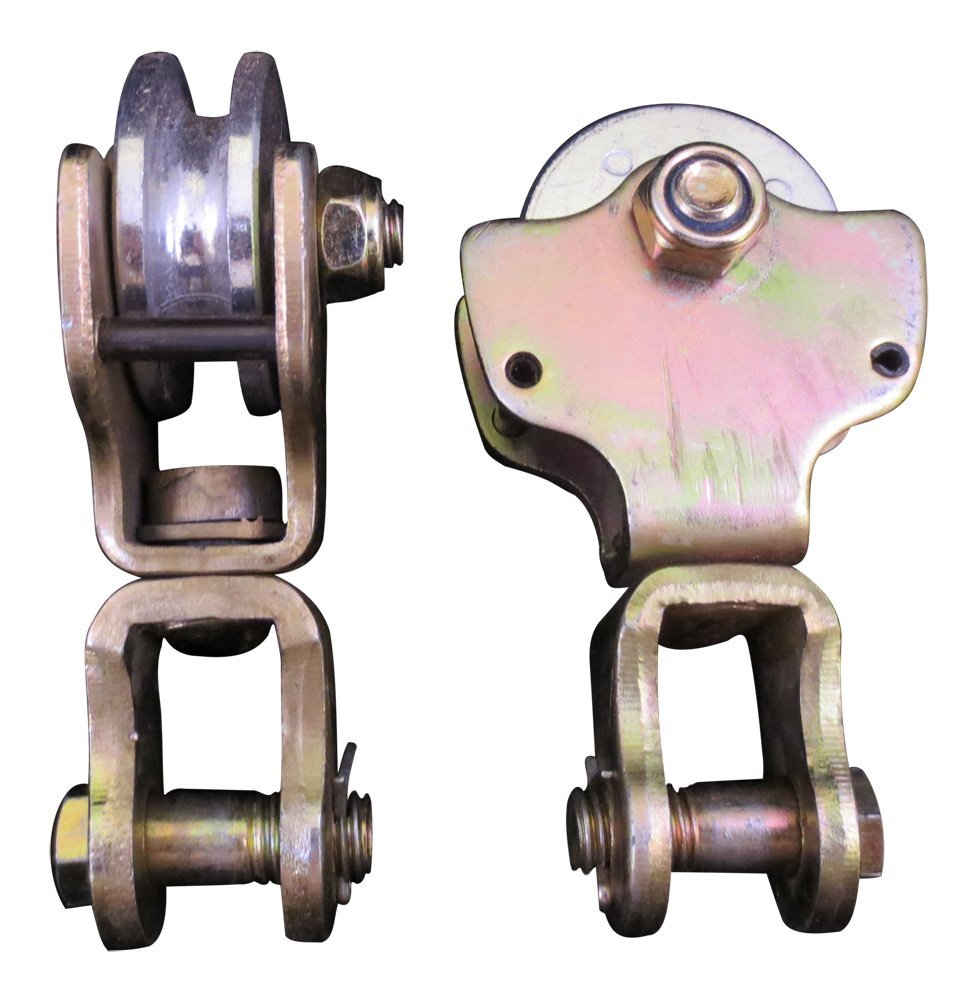

    And finally, I needed two swivel mounted pulleys to transfer the lift force from my Haulmaster Model 60344-47 Electric Hoist which will be bolted onto the passenger side wheel base mount at ground level, with the hoist cable guided vertically to the first pulley that will be attached to the underside of the cross-member and then routed 90 degrees over to the second pulley mounted underneath the middle of the same cross-member. Doing this pulley arrangement will allow the hoist cable and hook to move freely up and down, without having the big electric motor and hoist drive mechanism taking up all the space nearby and making it difficult to have easy access between the raised hood and the upper engine block. The cool part about this is that there are “STACK-IT BRACKETS” made for making firewood bins out of 2”X4” (Two By Fours) with built in slots at the correct X,Y,Z positions that allow for variable lengths of wood in all three axis and so the idea translates well into other uses besides just this one repair job and gives the builder the chance of a flexible application for the use of this device. Oh... and just in case anyone doubts that wood components might not be strong enough to hoist under these compression stress conditions, here is a link to the information necessary to know on the subject

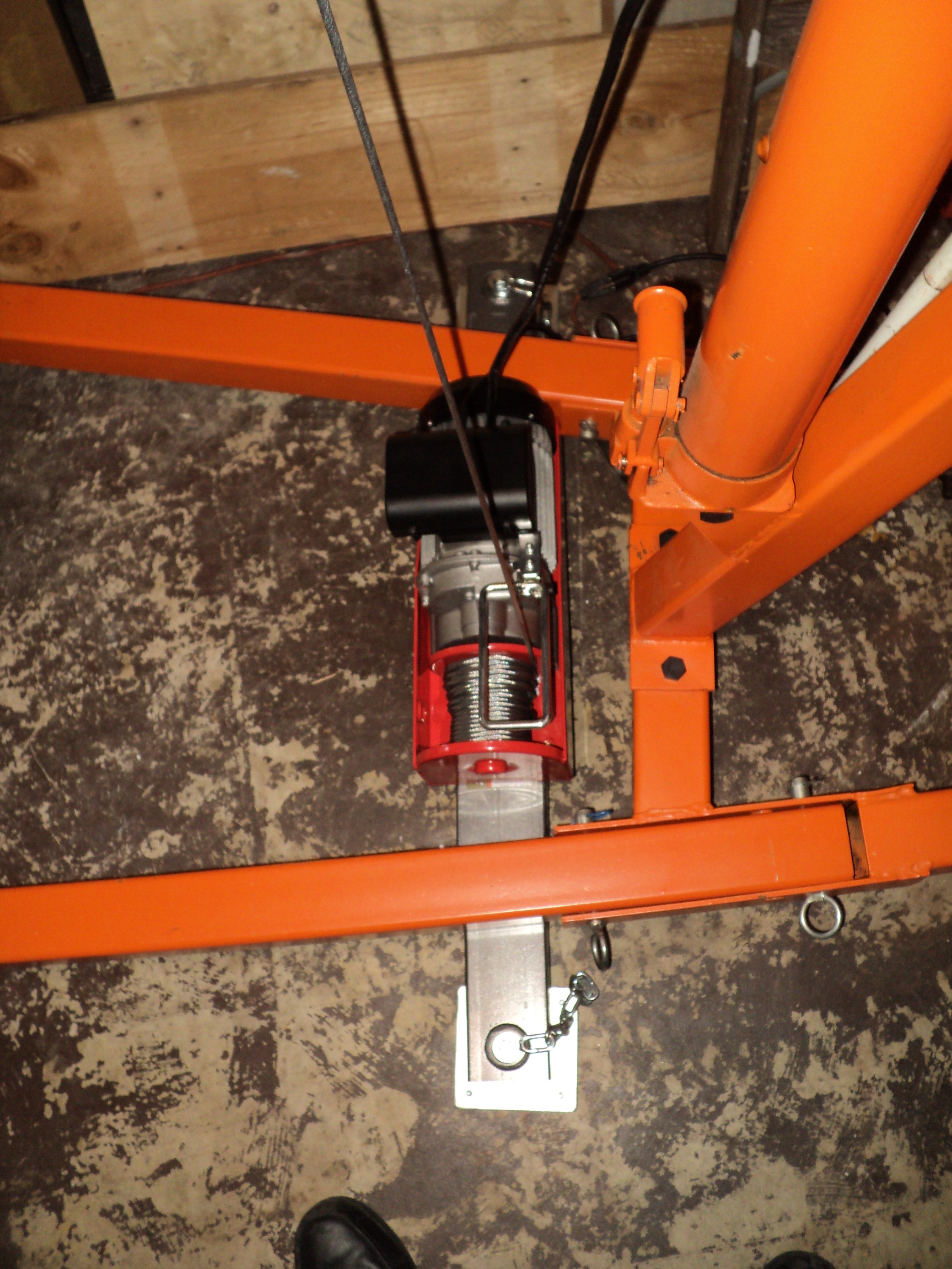

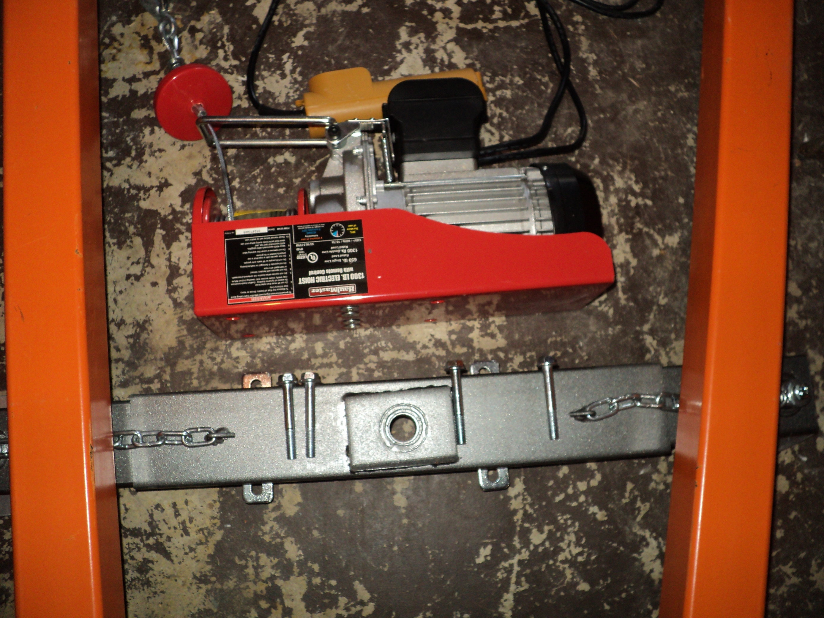

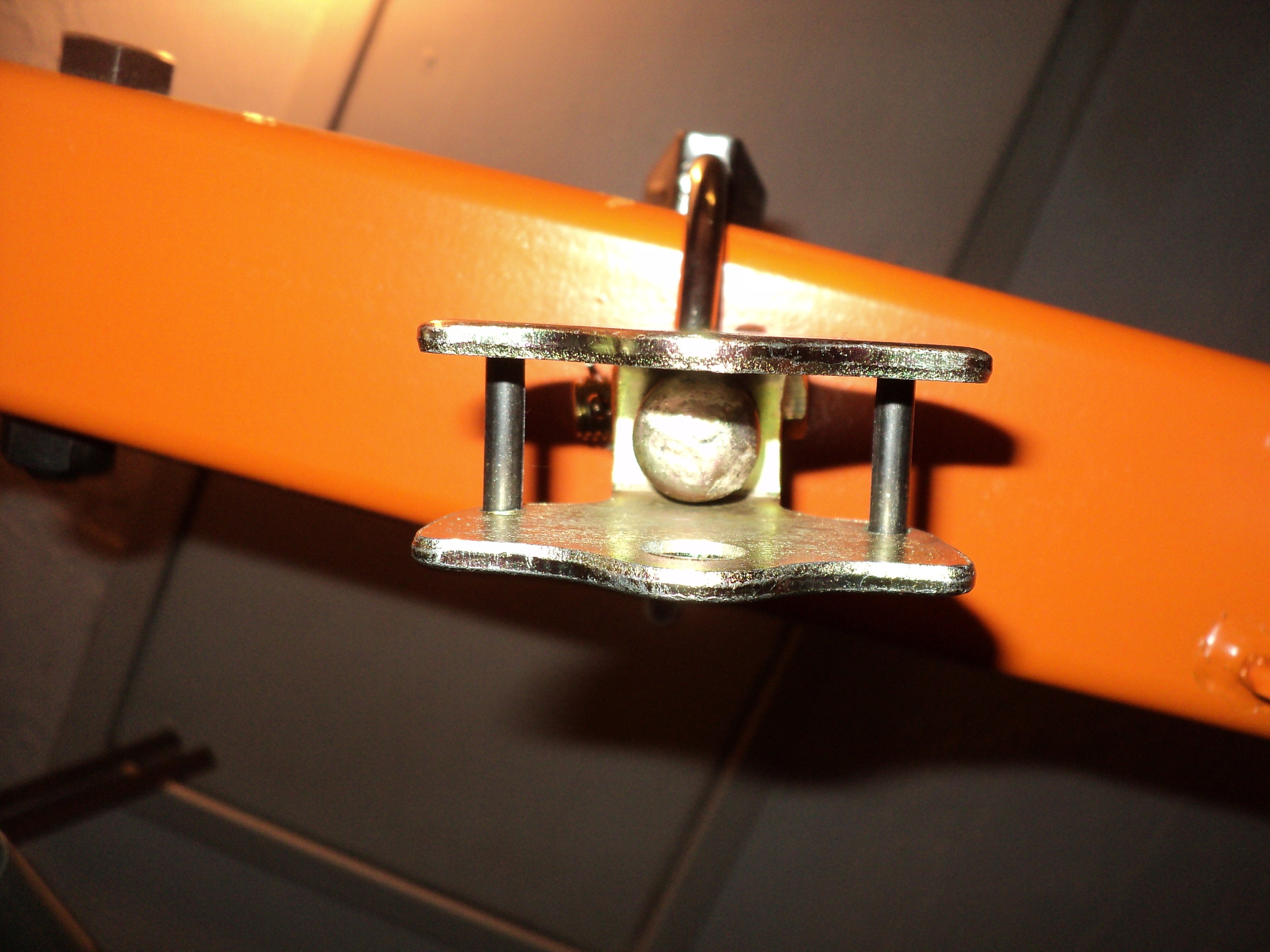

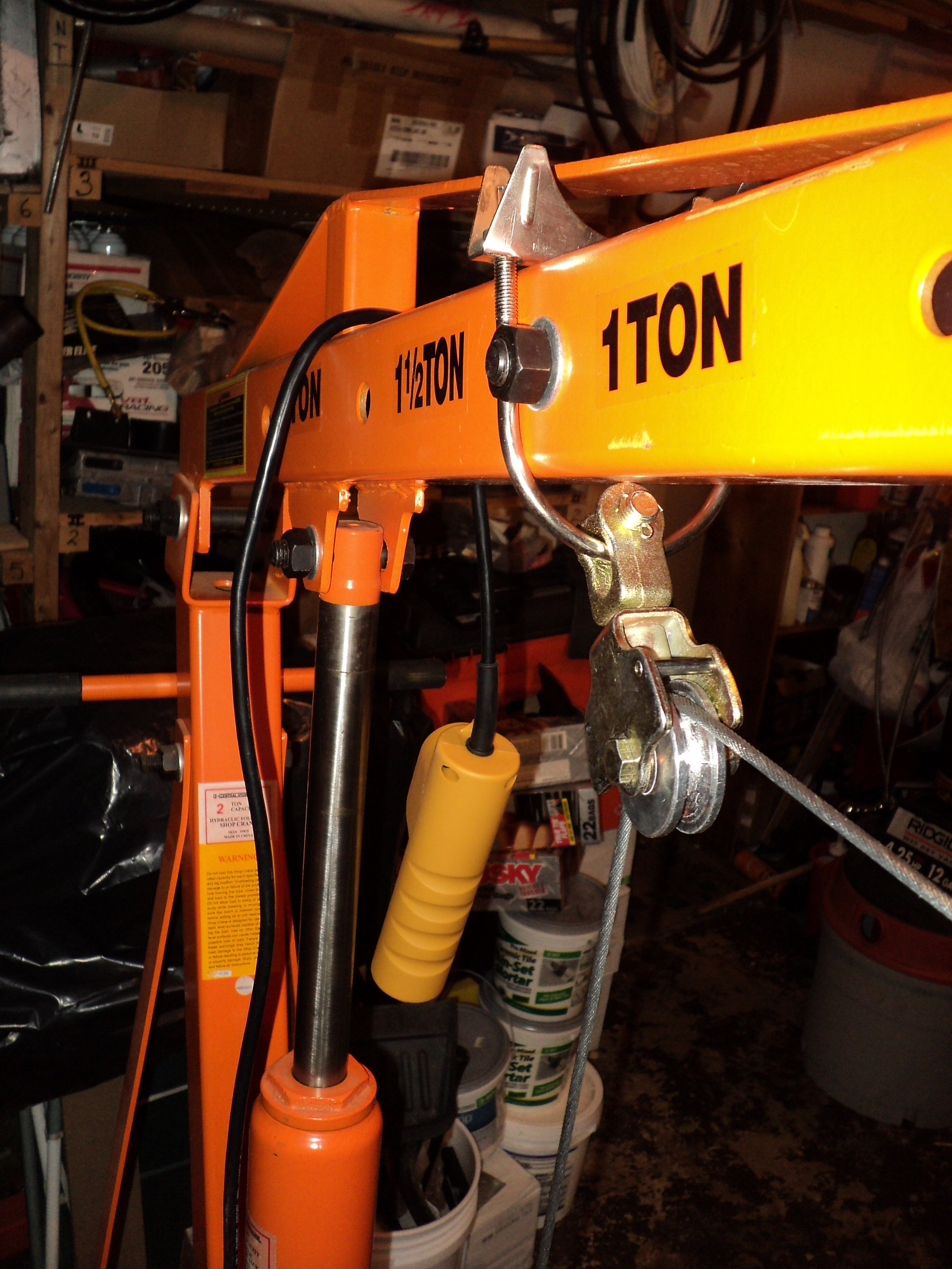

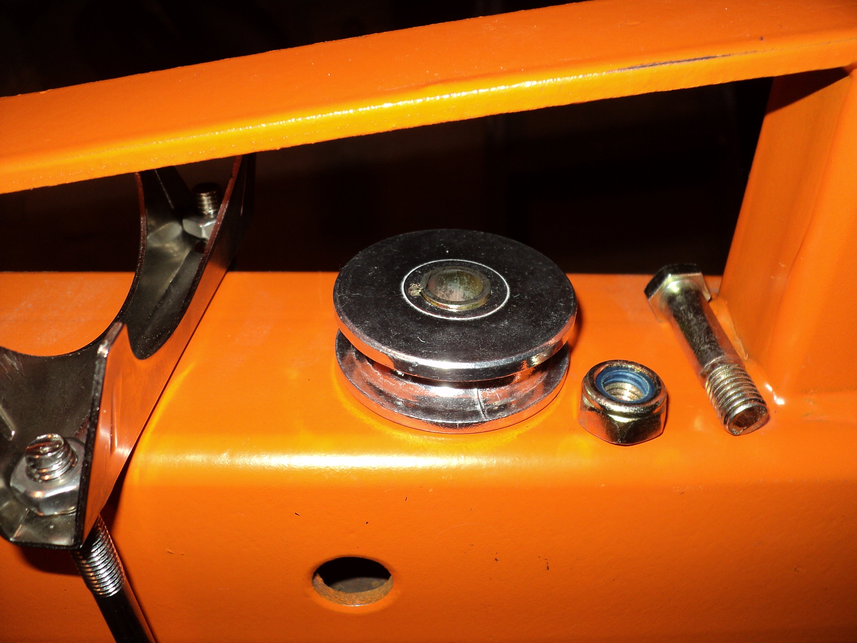

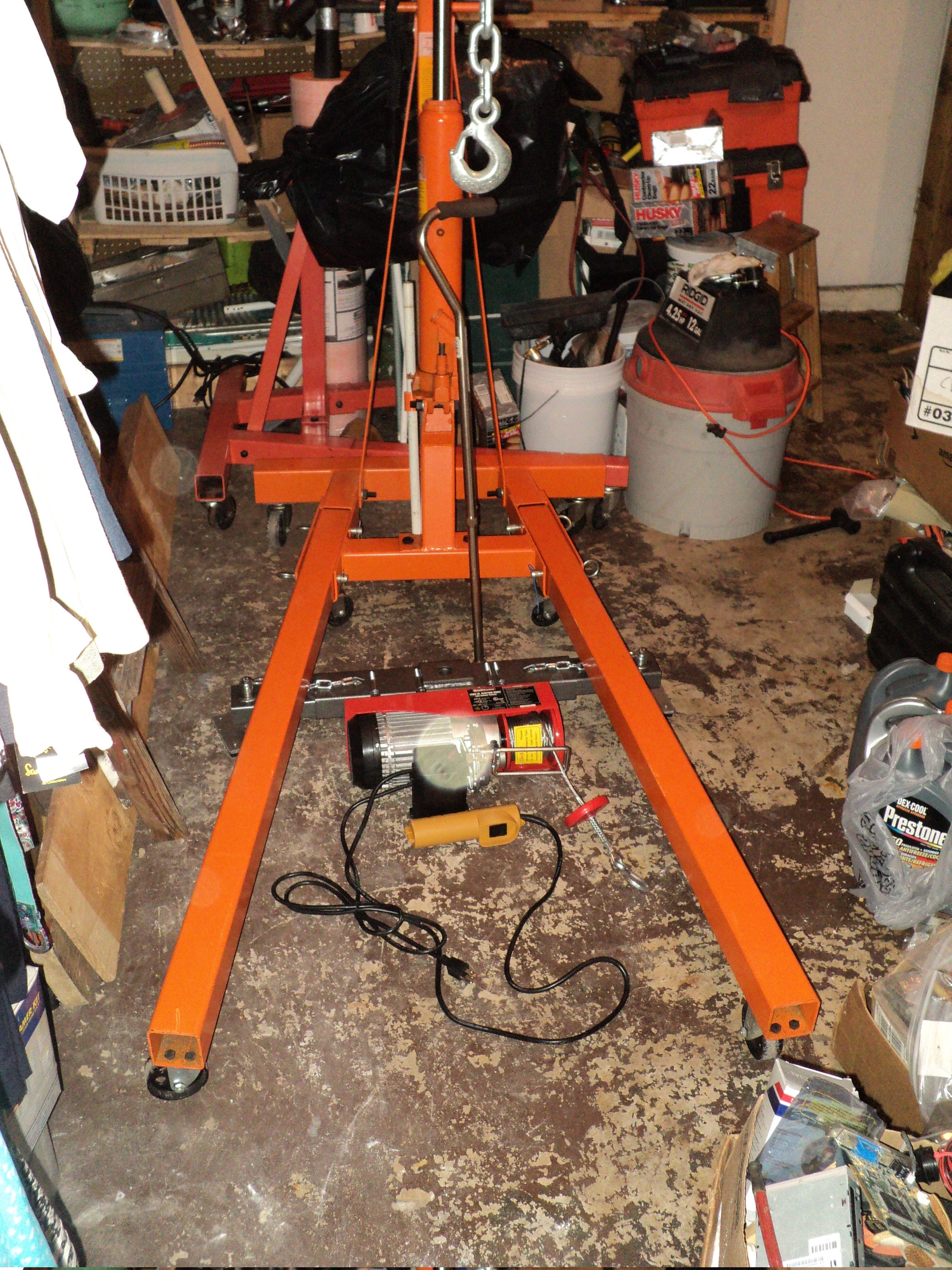

    Ladies and Gentleman... Without Further Ado... I give you... "The FrankenLifter" ....LOL
    COMPONENTS:
    All from Harbor Freight Tools in Largo, Florida
    2 Ton Hydraulic Lift (This the Primary Lift and it Remains UN-MODIFIED)

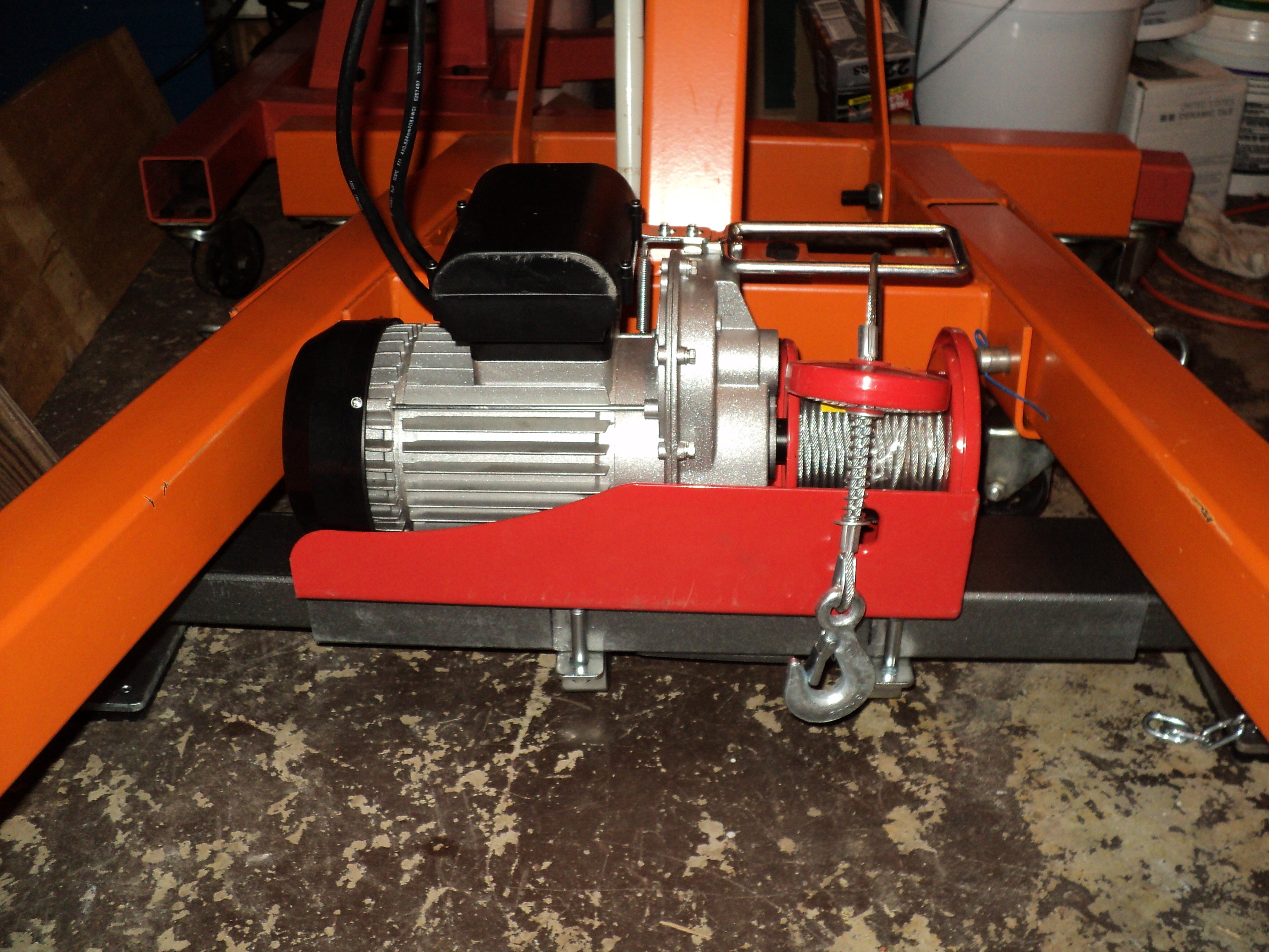

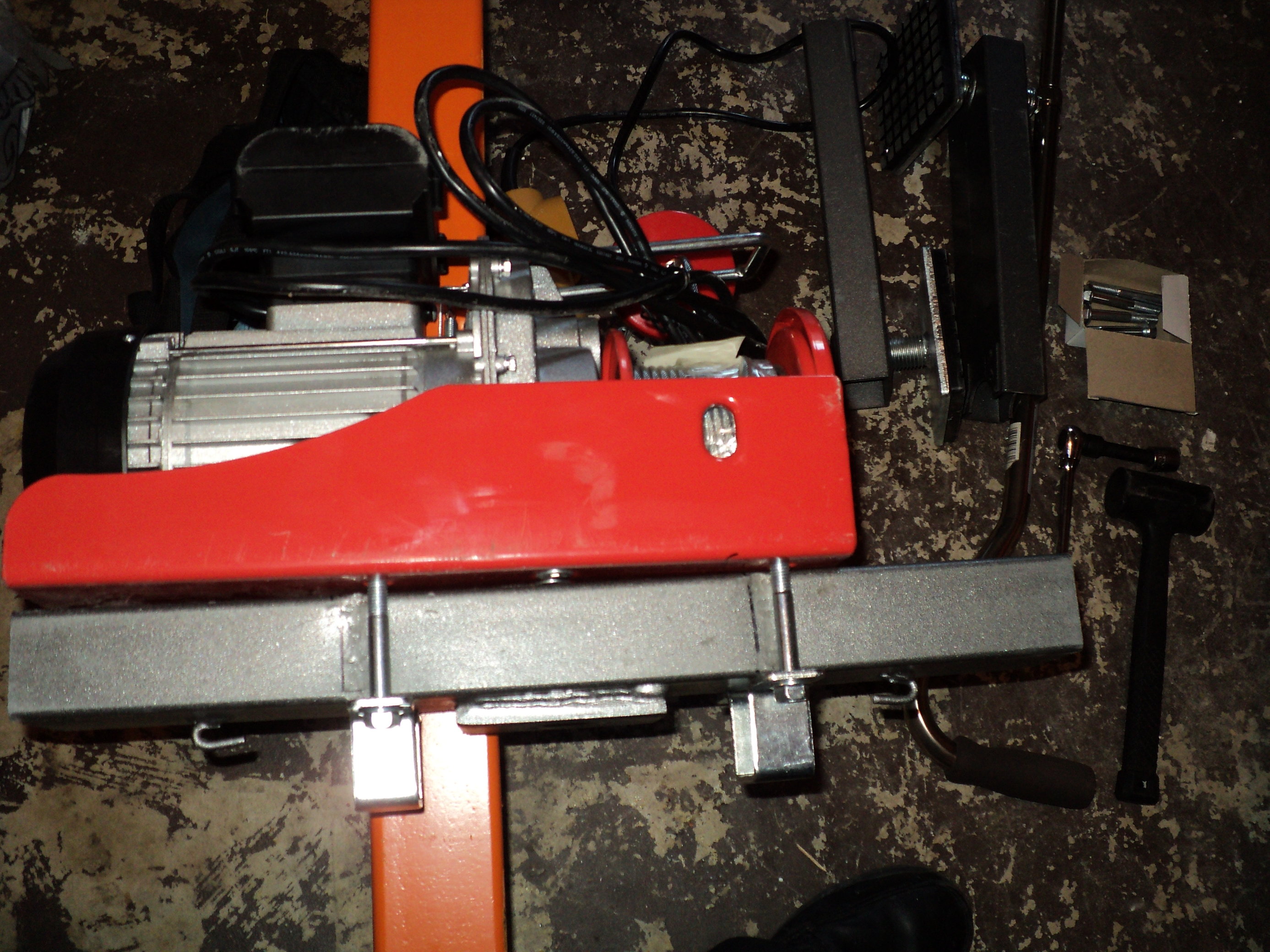

    1,300 LB Electric Garage Hoist (Bolted over the 2 ton Cross-Beam with adapted HW-4-Longer M10 X 70 Bolts and 2 factory brackets)
    2 Ton Pittsburgh Floor Jack Cross-Beam ( The beam is disassembled with the center square tube inverted and then all 3 parts combined)
    2 High Quality Pulleys with hardware allowance for dis-assembly to introduce the steel cable
    Some Basic Tools
    Stainless Steel Large U-bolt t(To provide a pivot point at a Right Angle to the Electric Motor and fitted in front of a Large Cross Bolt)
    Now I can pull the Trailblazer 4.2L Engine Head with micro-control and support items like the heavy cast iron exhaust manifold or... lift the front of the engine with ease long enough to pull out the motor mounts and drop in new ones... and NOT wind up getting injured again.

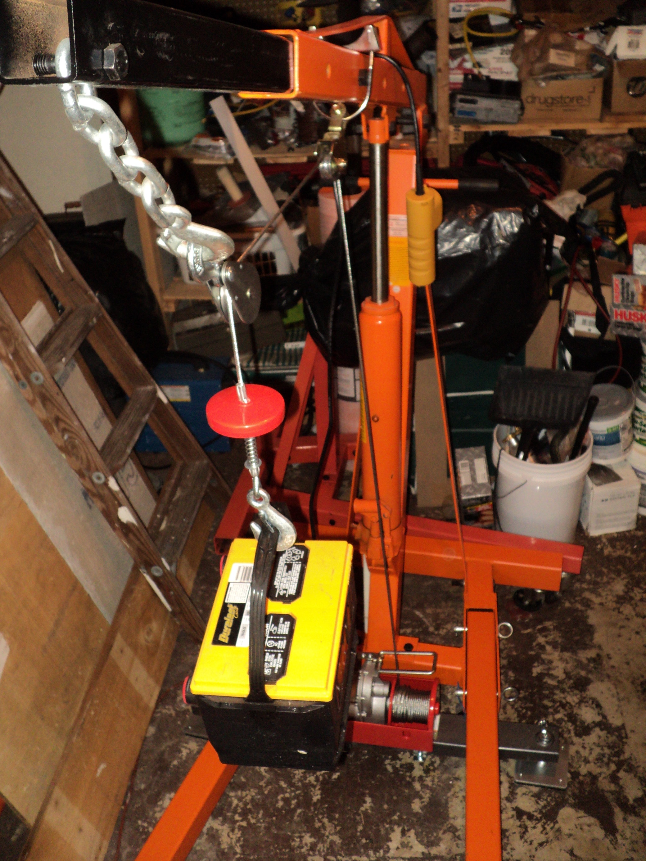

        Okay... I finally was able to play Garage Rubik's Cube well enough to make the necessary room I needed to finally test out "The FrankenLifter". I conducted a pretty good series of very successful tests and I observed some issues regarding Common Sense Safety that I will address below. I posted the 42 additional images on my Photobucket at this link:
        A Word or Two about How to Use this Device SAFELY!
        If you create your version of this device or use the design I have described, you assume full and entire responsibility and liability for doing so and shall hold harmless all, corporations, entities, and persons, living, dead and even those not born yet, harmless for any actions you take regarding the use of this device in every imaginable manner.
        Do NOT....:

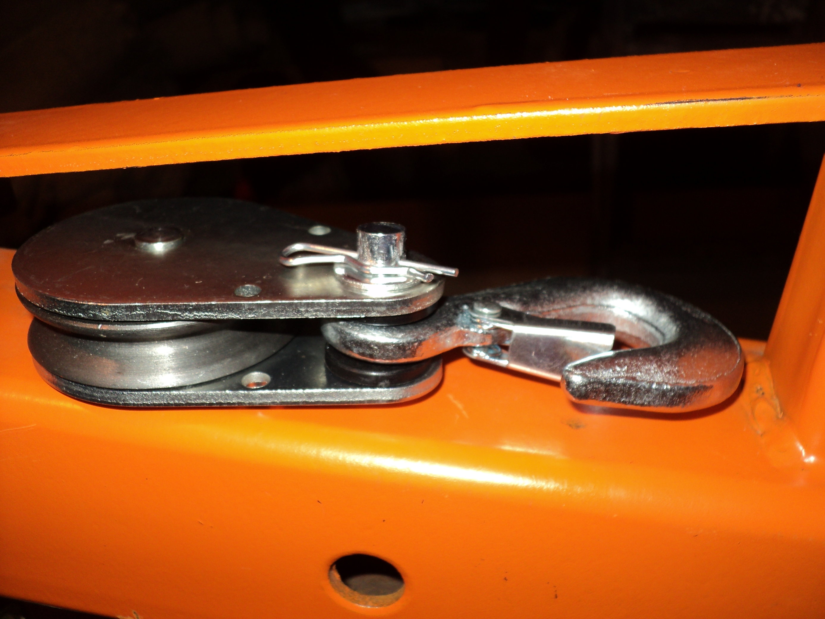

        Do NOT Run the Hoist Cable all the way to the Top Outer Pulley and THEN also try to use the Hydraulic Lift Pump handle afterwards! DOING THIS IS DANGEROUS!
        Why? Because when the cable Hook is foreshortened right up against the Upper Pulley... actuating the Hydraulic Arm has enough built in force to PULL THE CABLE TO HOOK CLEAN APART ...WITH OBVIOUS DISASTROUS RESULTS!
        What should I do instead?

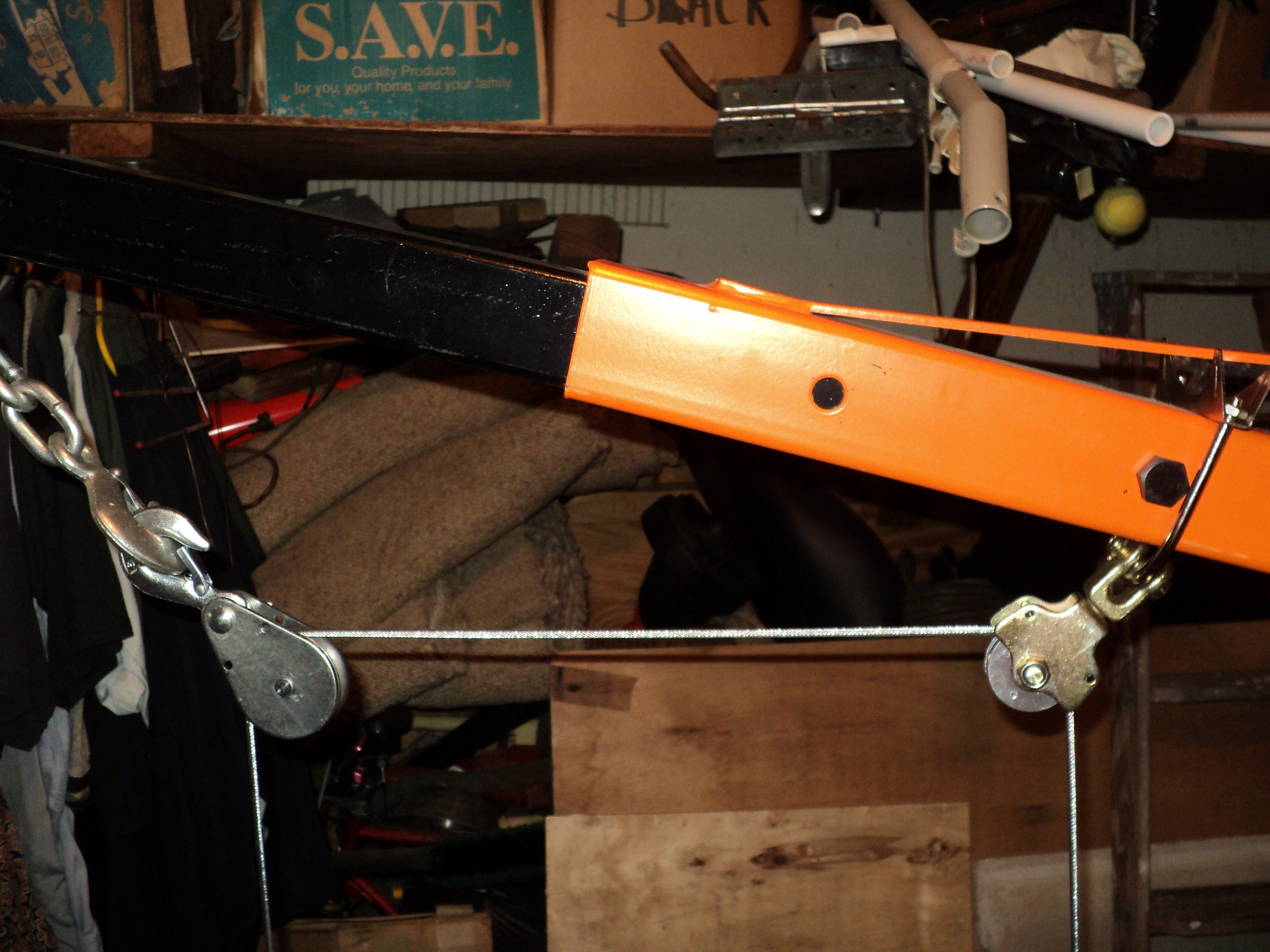

        First... if you need a greater lift angle from the Lift Arm...you should lower the cable hook to be below the upper support arm by AT LEAST ONE FOOT! Then as you use the Hydraulic Jack Handle to elevate the Lift Arm...you will notice that as the Lift Arm rises... the Cable Hook to Upper Pulley distance will get closer and closer to one another ...if need be ...keep lowering the cable again to keep at a least 1 Foot between them. Once the Lift Arm is where you want it... THEN you can use the Electric Hoist to once again raise the object on the hook much higher and not risk snapping the cable!
        Do NOT hold the cable while the hoist is being actuated either Up or Down.
        Why? Because you can have your hand crushed and your fingers amputated if you get them caught between the Hook End and the Upper Pulley attached at the Lift Arm.
        Do NOT allow a Second Person or an Assistant actuate the device when you are near the cable.
        Why? Because if you get snagged on anything...he won't react fast enough to stop it!
        Do NOT hoist ANYTHING and then work on it while it is suspended just from the Hoist Cable.
        Why? "The FrankenLifter" is like a hydraulic jack... in that you would NEVER get under a vehicle unless the vehicle is safely sitting on Jack Stands. Likewise with "The FrankenLifter" If you intend to work on anything suspended by the Hoist Cable...you MUST use a Strong SAFETY HOIST CHAIN to secure the suspended item to the Hydraulic Lift Arm... just in case the Hoist Cable SNAPS!
        Do NOT place any part of your body or hands underneath any objects being lifted.
        Why? In case the Cable Snaps and you get crushed, injured or killed when the object being lifted falls on you!
        Do NOT allow children, family members or by-standers anywhere NEAR this device when it is being used.
        Why? Because this device can be DANGEOUS to the Uninformed, the Unaware, and the Incompetent who may encounter it and think it would be fun to try and use it like a Toy!

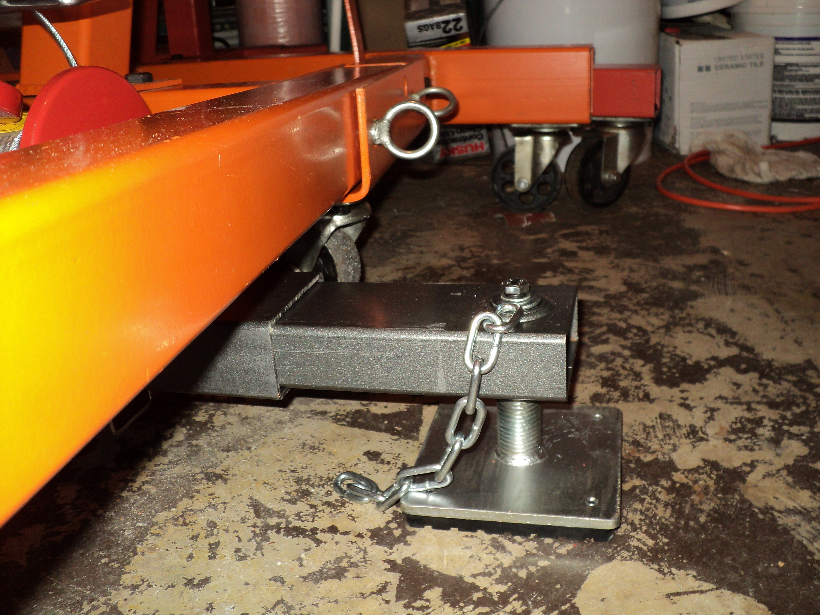

          I have made some additional modifications to "The FrankenLifter Hoist" since its original design.and posted more complete demonstration images of it in action while being used to lift a bare GM 1995 Lt-1 350 Engine Block. My investigation of its performance under a variety of lifting conditions requires that I post this Important Safety Warning mentioned here for anyone contemplating using this or any similar design and hardware they can build as follows:
          When using the Electric Cable Hoist Portion for Hoisting... Should it become necessary to Elevate the Lift Arm Hydraulically to an Increased Angle... it is imperative to LOWER THE LENGTH OF THE HOIST CABLE BEFORE JACKING UP THE HYDRAULIC LIFT ARM...and the safest way of doing this is to lower the Hoist Cable Hook DOWN to a Minimum Distance from the underside of the Pulley attached below the Lift Arm by at LEAST ONE FOOT (12")...!
          The Reason for this Precaution is that without adding in AND MAINTAINING the additional Minimum Length of 12" of Hoist Cable... it is possible to raise the arm with sufficient Hydraulic Force to actually PULL THE HOIST CABLE HOOK OFF OF THE CABLE...! As the Lift Arm is Raised... the Cable distance is DECREASED UNTIL THE HOOK BOTTOMS UP AGAINST THE LIFT ARM PULLEY. The Lifting Force of the Hydraulic Arm is 2.5 Tons...and could easily Rip the Cable Hook from the Electric Hoist Cable if it is allowed to do so with Catastrophic Consequences...!
          If this were to occur when there is any weight attached to the Hook... if the Cable Hook-to-Cable connection was to separate, the object would fall suddenly and there is the obvious risk of being crushed or injured if a person or parts of their body are under the weighted object during such an event. In another scenario...even if no injuries or death occurred... the elevated object would certainly suffer damage or destruction.
          Some astute observers among us may note that a few of the latest images displaying the L-Support Arm on the 1,000 Lb Engine Stand show that it appears to have been installed BACKWARDS. You should know that as soon as I observed this, I employed the ease of using "The FrankenLifter" to lift and hold the bare V8 Engine Block with the attached Engine Stand Bracket... while I immediately corrected and rectified this problem.
          I AM ALSO RECOMMENDING THAT A SECONDARY LOAD SECURITY CHAIN BE USED TO SECURE THE OBJECT BEING LIFTED AT ITS FINAL ELEVATION DIRECTLY TO THE STEEL SUPPORT ARM AND COMPLETELY ELIMINATE ANY CHANCE OF THE OBJECT FALLING DUE TO EITHER A FAILURE OF THE HOIST CABLE/HOOK... OR A LOSS OF HYDRAULIC LIFTING FORCE ON THE SUPPORT ARM.
