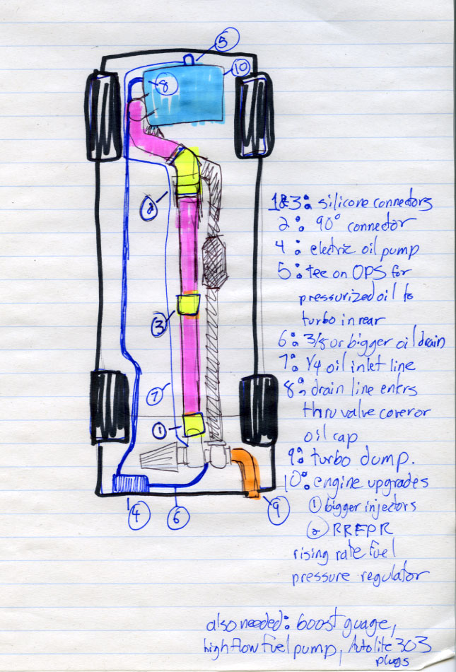

          just a quick sketch showing the basics of the rear mounted turbo system...now build it and go eat up some imports

            Why do people do this if you have room under the hood? They also use very small turbos to decrease lag...so no high HP/TQ #s.

              The main points:
              -easy to fabricate
              -can be used with headers
              -less risk of the turbo melting something critical
              -less underhood heat
              -the extra intake piping can help cool the air charge

                dont need a smaller turbo..shit i dont completely boost till almost 4grand..its nice..car drives around like its stock 98% of the time and the turbo is only there when i want/need it
