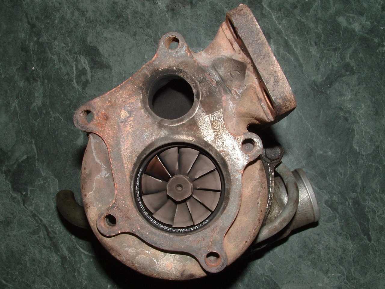

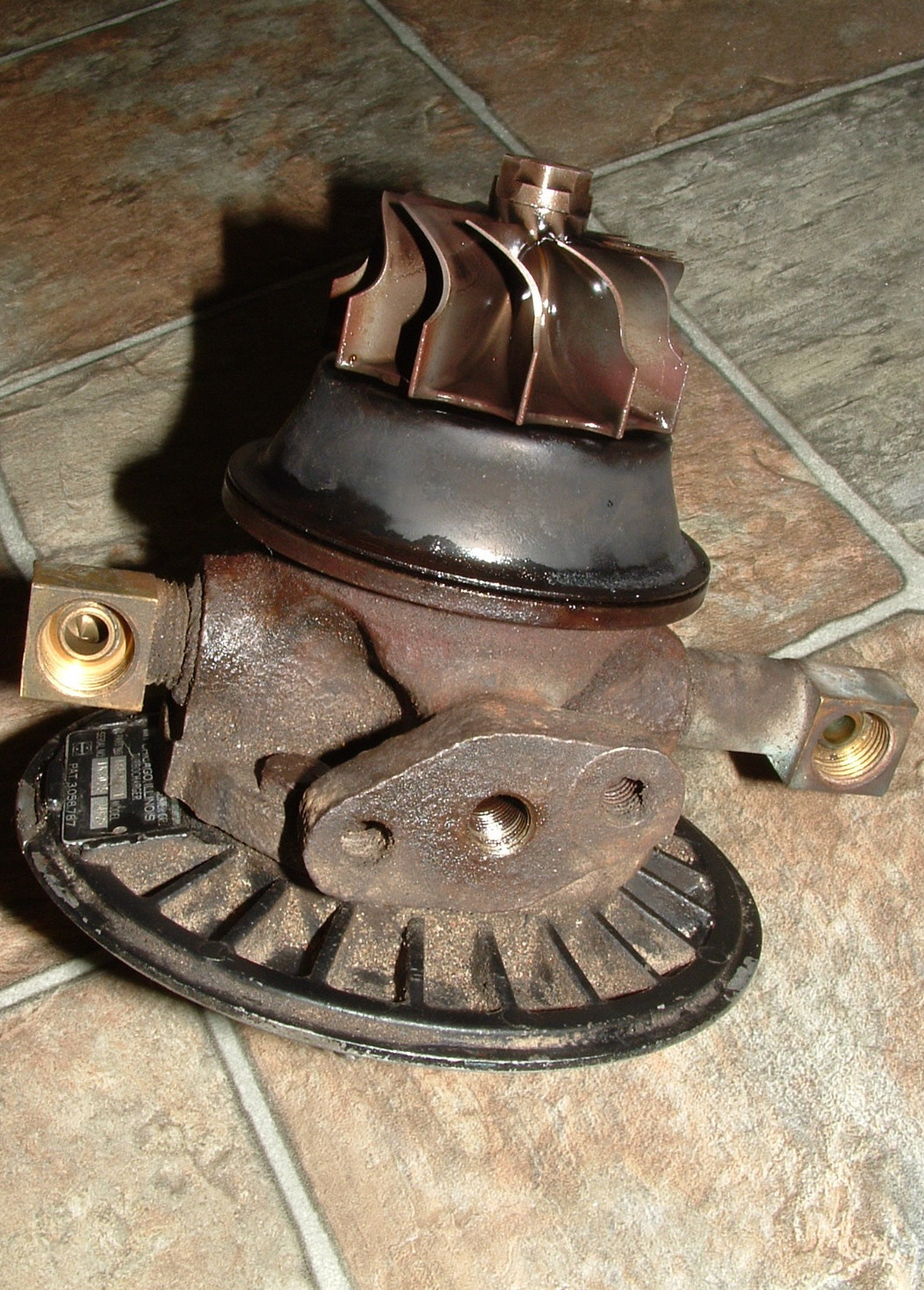

                  I've posted a couple of pics we took when we took it apart.
                  Thanks again for the helps guys!

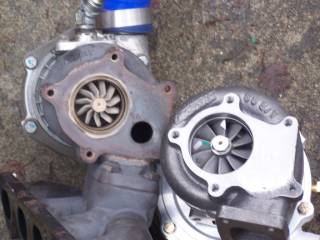

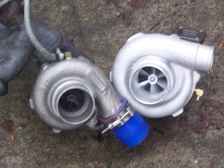

                    The turbo my buddy has even with the T3 exhaust housing can support upwards of 600 hp. Proven on Hondas. So it wont' be running out of steam anytime soon. He dynoed it. It pulls all the way to 6k rpm. Like I said, its a E based turbo, not a B. Big difference, even with the exh wheels.
                    Here is te difference. B style turbo on left, and his E style on the right.

                          I believe this turbine wheel would be considered stage 1. But again, no real info on it.

                          As I see it, the size and shape of the wheel, and size of the exhaust hole in the housing determines how restrictrive a turbine would be. For example, the picture Shaun posted of the T3 turbine looks much more free flowing than mine, simply because of blade shape and spacing. It may also have a different size exhaust hole, but I'm not sure.
