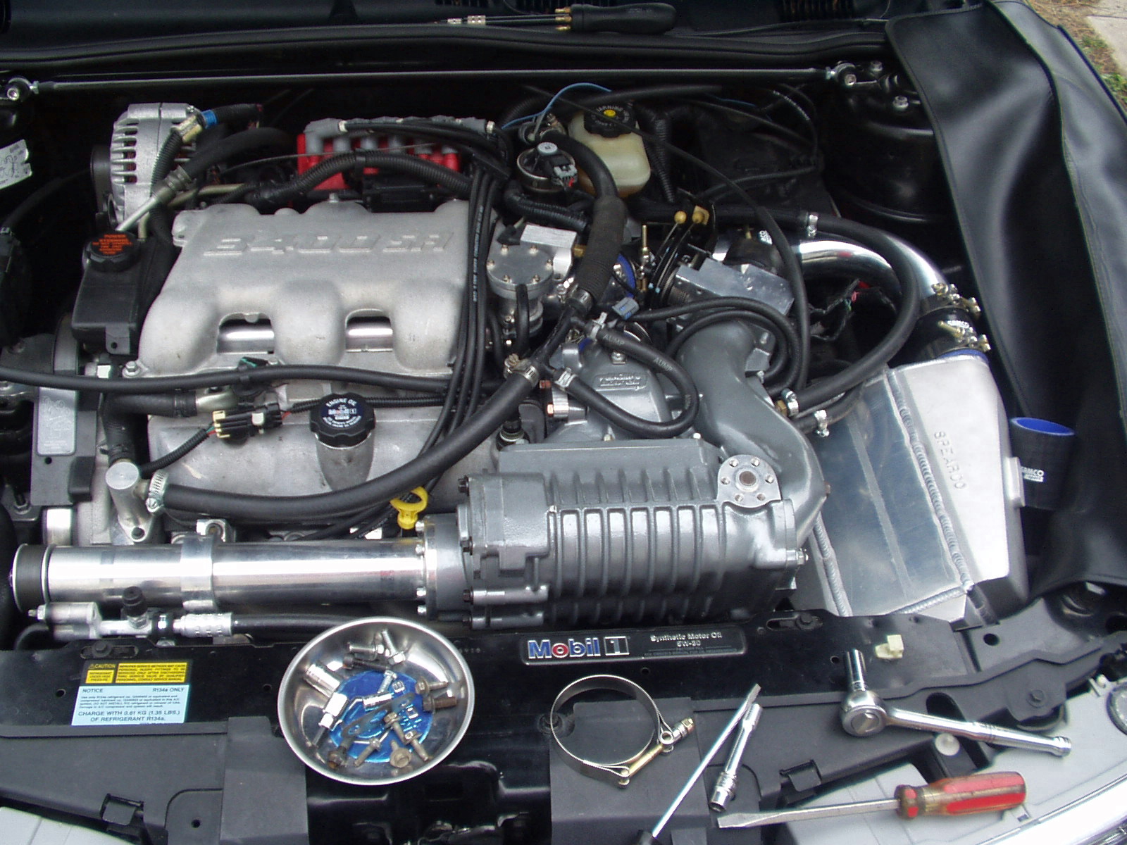

                            i got a pic of a supercharger here is this the one you guys are talking about ?
                              • 9190
                              Yes, that would the the Magnuson M62 kit.
