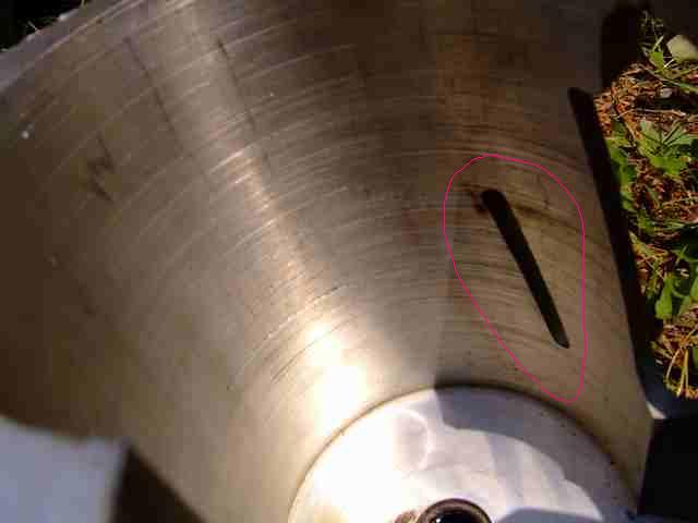

    here's a pic of the slots, filling these in apparently increases efficiency by letting less air flow back into the case.
