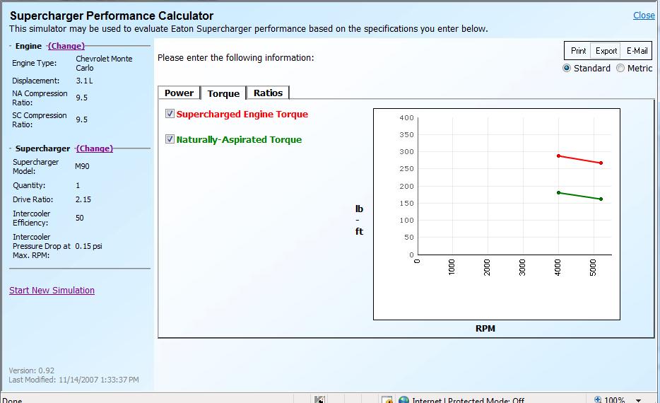

                      take a read(look actually):
                      thats the gen V M90...
                      thats the m112, i believe they were found on F150 Lightnings...
                      check that out as well: its a "simulator" to determine what supercharger from eaton would work best..
                        i just did the sim, and here's what i got:
                        SuperchargerPower 39.484 kW 68.194 kW
                        EngineSpeed 4000 5200
                        SuperchargerTorque 43.843 Nm 58.248 Nm
                        EnginePower 218.798 Hp 264.272 Hp
                        NaturallyAspiratedPower 137 Hp 160 Hp
                        NaturallyAspiratedTorque 243.891 Nm 219.105 Nm
                        EnginePressureRatio 2.62 3.06
                        EngineTorque 389.51 Nm 361.896 Nm
                        this is for a small port 3100 with a m90...
                        and i included a pic for toque since i don't know Nm... and the pressure ratios seem to say that it certainly isn't too small for a 3100...
                        and this is all with a 50% efficient intercooler...

                          thanks a bunch man-ive been looking for that info for the m90 for quite a while now! you dont happen to have any charts like that for the garrett turbos do you?
                          how would you do that sim for the 4.0 32 valve v8? i dont know if its not working for me but it only lets me run numbers for 2.0 dohc engines & then i dont know what info to put into the calculator
                            i don't, but squirrel performance does.... and their calculator is pretty nice
                            squirrelpf.com or something like that...
