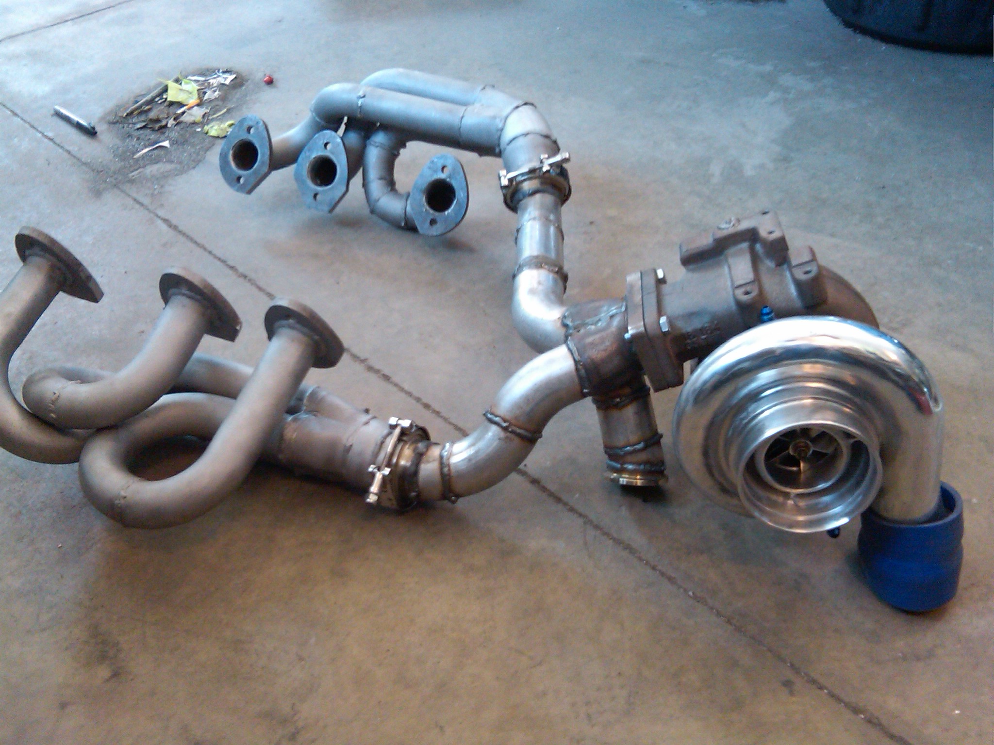

    Turbo Headers
    Something like these, though they would be the most expensive and I have no one who can weld these for me.
    Any thoughts, opinions, anything?

                      you wouldn't have to port or modify the 3500 "header" manifolds in any way. Just use a few U bends to make the crossover.

                        On turbo cars I highly doubt an elaborate exhaust header is going to be significantly more effective on a street driven car than a well designed simple log style manifold with exhaust flow directed toward the turbo. In other words no 90 deg "T" intersections, if all ports leading into the log are slanted toward its exit end you probably will not notice a difference between it and a header that results in upwards of 3 or more times the exhaust tubing volume that has to be filled before it reaches the turbine.
                        It's hard not to be creative but I'm learning that except for the return I received on the expense and effort of putting an intercooler at the front of my car, headers for a turbo on anything less than an all out racer are not justified. I've gathered that from what I've read and experienced. Turbo vs. Supercharged vs. Naturally aspirated all have different flow characteristics, call for different camshafts for optimum performance and therefore respond differently to header exhaust systems and I believe turbos show the least positive response since at full load the exhaust pressure is usually 2 or more times that of the intake pressure. They're probably great for managing pulses but I don't think they are able to do much if anything for scavenging which is very important.
                        My headers are coming off and being replaced with a tubular log design for space savings and simplicity. The cast iron manifolds are great to if you can get the flow ironed out, I would not block off the exit end of the rear cast manifold in an effort to get it to flow out the inlet end for the front bank, the contours oppose it and the result will be poor flow characteristics especially for the cylinder furthest from the exit.
                        Spaghetti headers look great but I highly doubt they payoff in performance what they do in looks. I'm tired of "taking the back door to get to the front yard". It causes a lot of unnecessary down time and expense.
