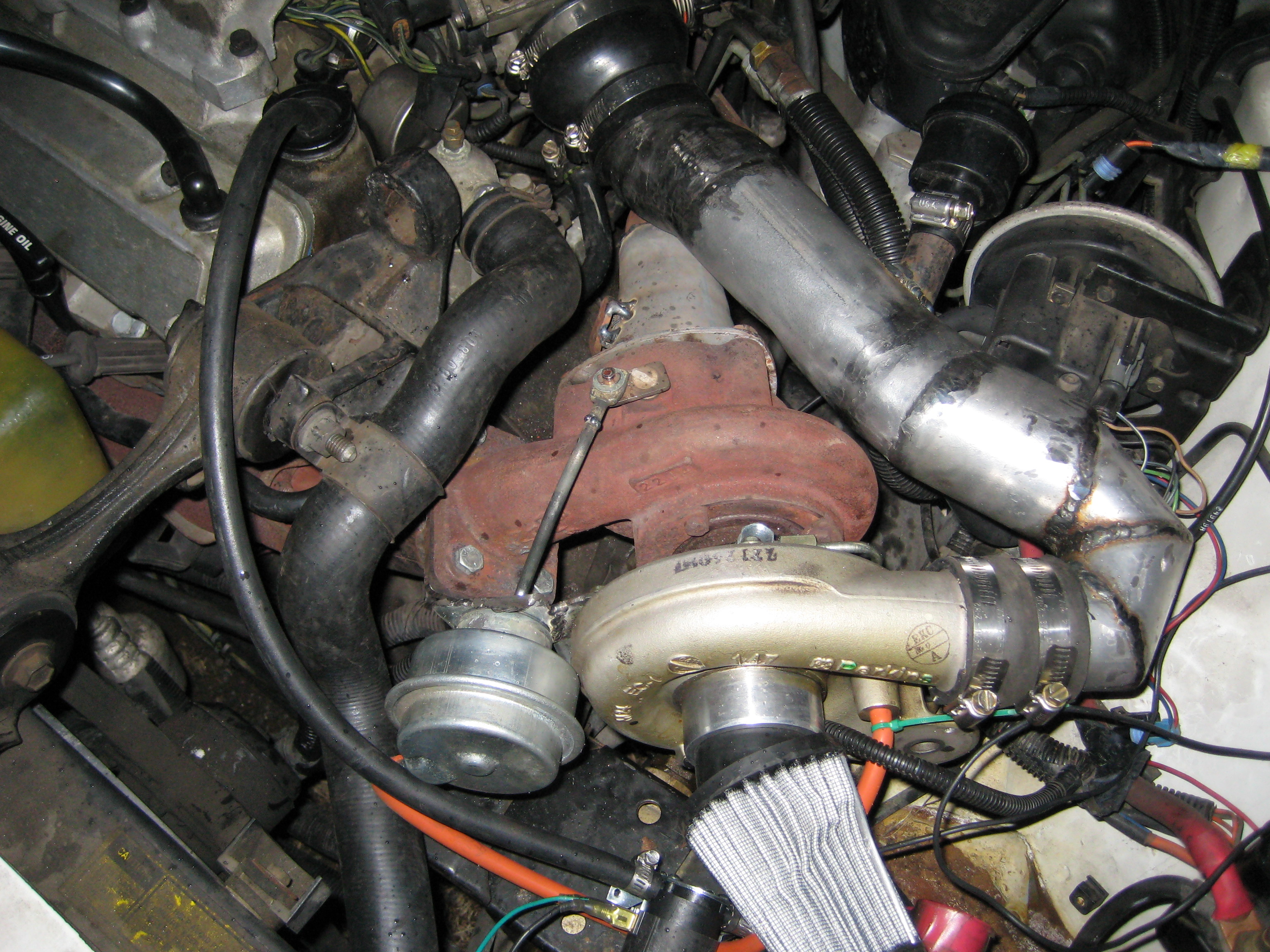

    Hello All , been trolling for a while . I picked up a garrett perkins diesel turbo off eBay for 100$ and built it into the crossover pipe on my 90 Lumina , Now this turbo came off a 3 cylinder. I figured why not run it the same way on my Car .
    so it now get's fed exhaust from the front 3 cylinders and boosts the whole engine. I definitely feel it in the seat of my pants and it works NICE ..Pics to follow (as soon as I'm able)

    I want to see this.
    Saab did that for a very short time, but I can't imagine it's healthy for only one side of the engine to see that kind of an exhaust pressure differential between banks like that.
    What did you do for tuning?

      Check it out... no Inter-cooler and I haven't put a boost gauge on it yet. it don't feel like any kind of HIGH boost , maybe just getting it to atmospheric ? the turbo gets fed from a sandwich adapter at the filter , and gets restricted at the turbo to .030 , scavenging is done by a El-cheapo eBay electric scavenge pump, Works Great. I've got another turbo that might fit the bill for going out back of the car ... Whatcha think ?
      I did NOTHING for tuning . No CE Light. & those spots are raindrops , Not OIL !
        With out a tune, you will not get the power you could have and possibly blow up your engine. You are risking a dangerously lean condition when you go WOT. And you will not get a CE light just before it grenades itself.
        I'de be very careful messing with boost with out the proper considerations. There is a reason people suggest a tune along with other recommendations like increasing the fuel delivery system.
        But then again, if the boost is low, you may be ok. Hard to say.
        Good luck
          i do NOT see that engine lasting too long boosting... the MAP can't even read boost, so you could be pushing 5 psi and the ECM wouldn't know it, meaning you'll be running lean as hell with too much spark...
          at least tell me you put the highest octane fuel you could get ahold of in it.

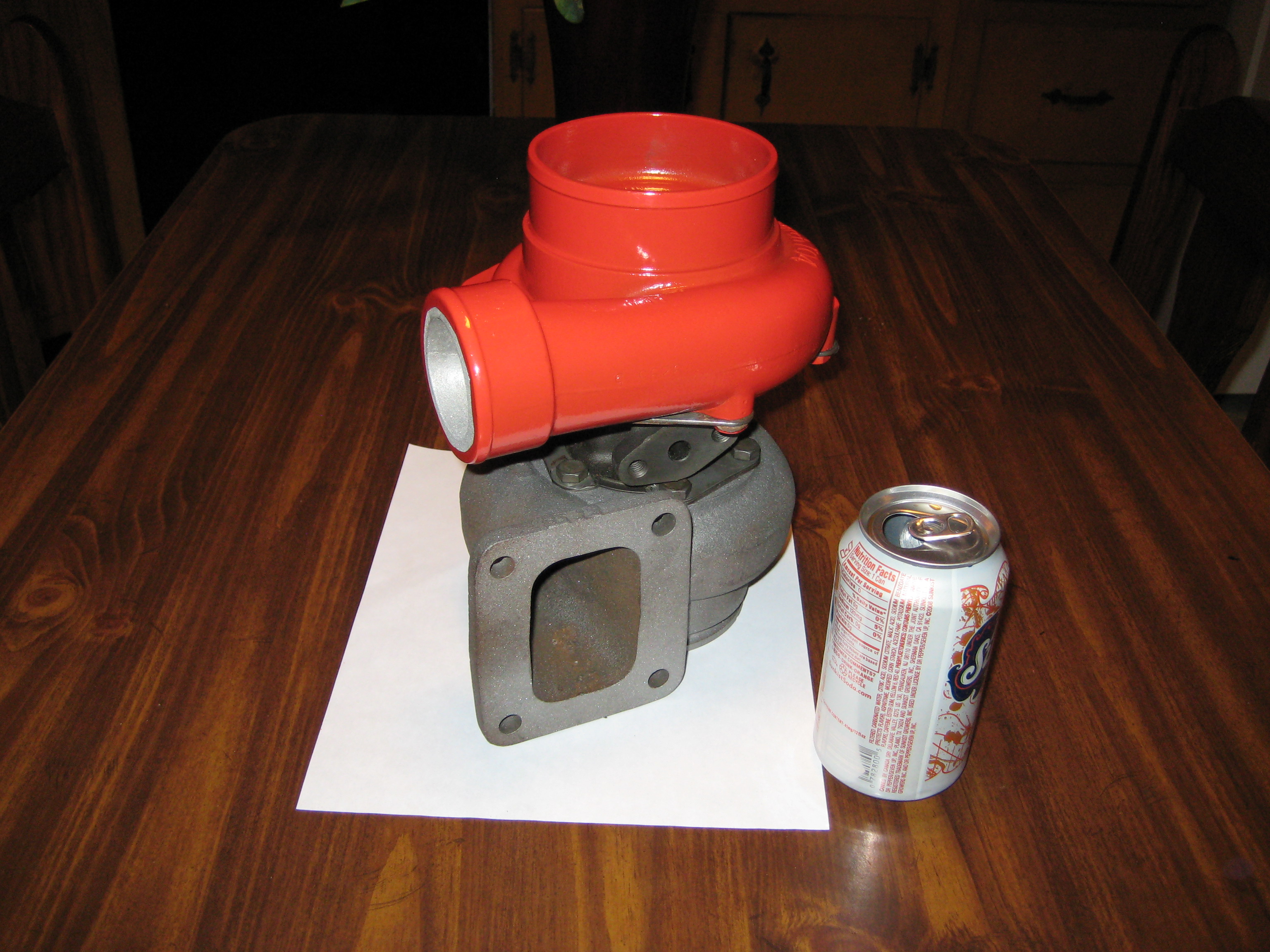

                    I checked it for boost and I'm seeing 2psi +or-.5 @ the regulator . I've disconnected the Gate as of now , I Popped the intake pipe and it's pushing a little oil. Whats your feelings about the red one I got ? its a t04. I was thinking of running it out back Ala' STS style ?
                    • RedZMonte
                      • Feb 2004
                      • 1378
                      Im not a fan of STS setups... NHRA rules won't allow them to run at any NHRA event IIRC..... so if you plan on going to a drag strip for anything other then a T&T i would say explore other options... Plus more parts more potential for failure (oil pump, LONG oil lines, ect) Not to mentioned they generally spool pretty slow and have to push all that air back to the front of the car (slow responce)....
