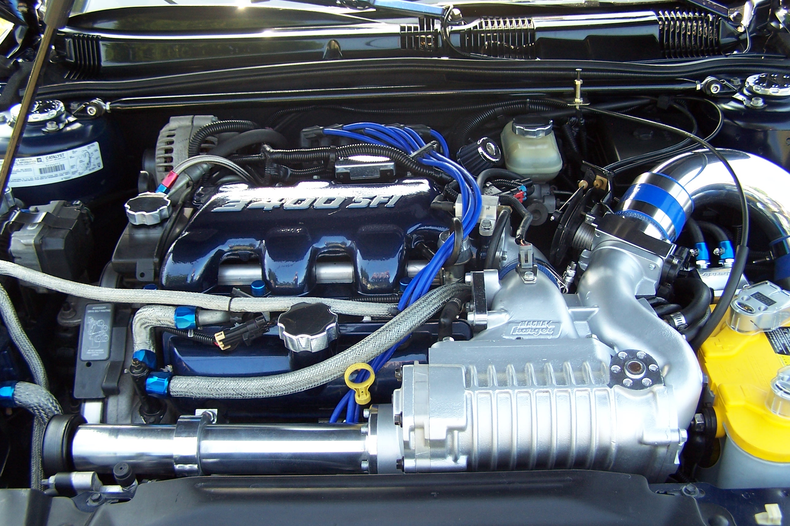

what supercharger is this?
That is one of maybe 8 or 9 supercharger kits that Magnacharger fabricated for the 99-04 V6 Grand Am. It was based around the Eaton Gen IV MP62 blower, with a custom-cast inlet/outlet assembly and the extended driveshaft. With the stock 2.8" blower pulley, they produced roughly 6psi and added about 60HP to an otherwise stock car. They originally sold for around $3000US. There are still a few floating around, and are very sought after. They come up for sale once in a blue moon. You can only get them used, and most have seen several owners (yours truly included).Last edited by mfuller; 04-20-2010, 09:57 PM.Matt

I believe the official number is 17 kits, 10 gen 4s and 7 gen 3sOriginally posted by mfuller View PostThat is one of maybe 8 or 9 supercharger kits that Magnacharger fabricated for the 99-04 V6 Grand Am. It was based around the Eaton Gen IV MP62 blower, with a custom-cast inlet/outlet assembly and the extended driveshaft. With the stock 2.8" blower pulley, they produced roughly 6psi and added about 60HP to an otherwise stock car. They originally sold for around $3000US. There are still a few floating around, and are very sought after. They come up for sale once in a blue moon. You can only get them used, and most have seen several owners (yours truly included).
and I too am a former owner of one...
Are they not that impressive? All the time I seem to read about them changing hands.-60v6's 2nd Jon M.
They are great kits, and with minimal supporting mods can give you 250-300whp. I know several people have sold them when they upgraded cars. No reason to leave them on and sell it with the car. Also people sell them when they are in a pinch it is usally a quick $2000 or more. And lastly people (including me) sell them because that simply is not enough power and move on to bigger and better things......Originally posted by pocket-rocket View PostAre they not that impressive? All the time I seem to read about them changing hands.

The picture the OP posted is mine. I sold the kit now and as far as I know it was the last m62 that has been up for sale for quite a while.
