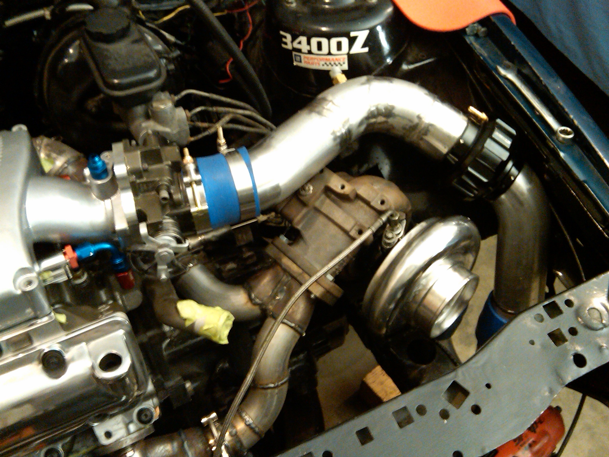

                I wish I could find a compressor map for my 48 trim wheel, but, after searching... I cannot. Seems like a small 61mm inducer for an 88mm exducer, but the price was right.
                There it is beside my t3/t4 59mm turbo. cute.

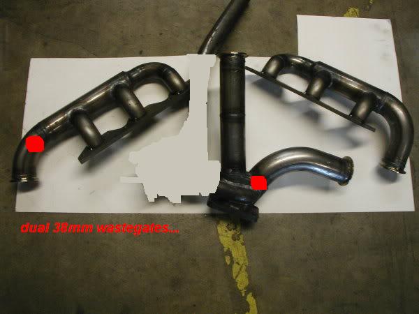

                    Hi again,
                    ok, so I think I've decided to go with dual 38mm gates.
                    My last gate was a 50mm 50$ ebay knockoff and it works flawless with my Greddy EBC. So why not spend a 100$ and get dual 38's keep the banks seperated...
                    Question :
                    would this location be alright for dual gates or do they NEED to be right beside each other just before entering the turbine ??Click image for larger version
                    It's just that with the headers, oil drain, ect ect it would be nice if I could keep one of the gates a little closer to the drivers side...
                    thanks.

                      Hi again,
                      Question :
                      would this location be alright for dual gates or do they NEED to be right beside each other just before entering the turbine ??[ATTACH=CONFIG]5231[/ATTACH]
                      thanks.
                      Cool! I have always been told both gates as close to the turbine as possible, especially for better response and control. Plus it is better to tee the vacuum lines from one source, the wgs will have to be closer for this. How are you planning on configuring the turbo? N-S (90^) or W-E (parallel) to the engine? You can run a pipe along side both primaries to give you room for the Wgs?

                        I want to keep the turbo in more or less the same location as it is now. I like how the exhaust goes straight back and I like the oil drain angle from the turbo, good drainage angle. I think the way I have it layed out in my head it'll work out fine with the dual 38's. Might not be 100% ideal, but should work.
                        I just ordered the gates today as I type this.
