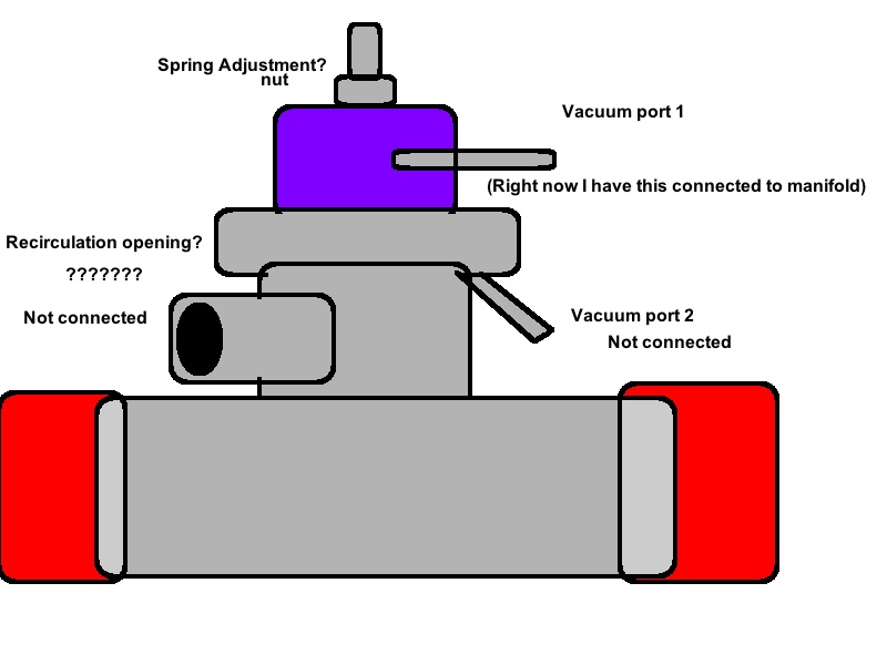

                      But major question, does the bov need the recirculation connected to the intercooler piping? Cause it is wide open now, but some people said their car needed it recirculation so it doesn't backfire or stall...???
                      Secondly bov could be connected to the intake manifold directly right? Cause some people told me to connect it between the tb and maf? meaning connect to the tb vac lines I have? Cause I got it connected to the uim by itself for bov.

                        BOV needs to connect to charge pipe, AFTER turbo, but BEFORE MAF.
                        The BOV needs to releive the turbo compressor when the throttle CLOSES. Therefore it needs to be before the throttle.
                        The MAF needs to ONLY measure air that GOES INTO THE ENGINE. Therefore it can't have a BOV after the MAF. That would allow measured air to exhaust to the atmosphere after the MAF.

                            The BOV can be before or after the MAF, depending on the set-up. When the throttle closes, the excess boosted air will bounce off the throttle plate and force the turbo to spin backwards. The BOV prevents this by releasing the airmass only when a vacuum in plenum and positive pressure in the intake are present.
                            If the BOV is after the MAF, the airmass that is released after boosting up is already measured by the PCM. The PCM will command enough fuel to make the desired AFR (air fuel ratio). BUT the measured air isn't there anymore, it was released. So the much less dense intake airmass is over fueled and that results in a stall. Two ways to prevent this......pipe the released airmass back into the intake somewhere after the MAF or place the BOV before the MAF.
                            Placing the BOV before the MAF is a simple solution.
                            The vacuum lines to the BOV should be routed to the Plenum. You also need to adjust the top screw if you have one. It will increase/decrease a springed force against the valve. If the spring is loose, air could be drawn into the intake lines. If the BOV is placed after the MAF, you would be adding unmetered air to the intake. This will make the AFR lean, especially during cold start up while in open loop.

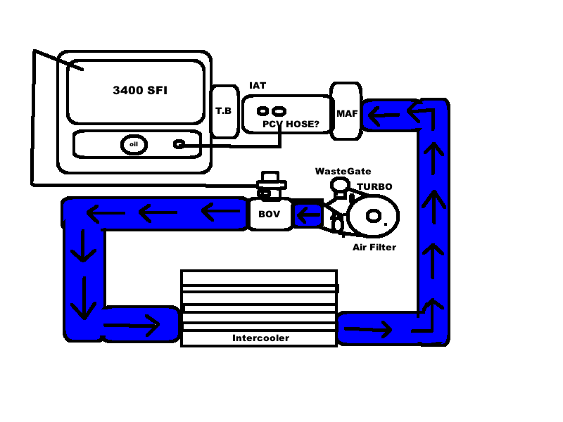

                              HI quick update I guess. I haven't been able to work on car for about a week and half because My main ride to work broked down. My dodge Caravan's transmission exploded on the differential part and made the whole trans useless, so went to rip a working one out from a parts car and swapped it, which sucked.... financially.
                              Well in past 2 days the custom 3" exhaust is done, and it is nice, and should be where I want the sound to be during the testing we did today. (basically from front to back, glowshift o2 sensor for wideband, then got flex pipe, then magnaflow cat, then o2 sensor, then magnaflow muffler for a resonation, then ypipe to 2 Ford Mustang GT 2011 mufflers..... Yea I know I got like 20 make/models on my car now...)
                              SO We tried routing the wastegate to the throttle body vacuum port since we saw how david's diagram has the line going in between the maf and throttle body, which confused me, I thought we weren't suppose to allow change between those two things. WHere exactly is the best position to put that wastegate hose???????
                              Then I think I found out why the car keeps stalling. I believe that one of the fuel injectors are not installed properly and is just sitting there. But will check to find out. We will be working on that when we got time. But I am not sure if that is the main problem.... I wish someone can tell me what is wrong.
                              QUESTION, on the boost gauge does it only read vac untill boost comes in before it reads boost? Cause it seems to not be gettng boost, also I do no know why the brakes still not working well or not working at all. Is there something I am connecting wrong? and I thought those got check valves as a failsafe.....
                              Here is the stuff I drew today just to show you what I done, and if you look at the bov pic I hope I didn't miss anything...Click image for larger version

                                Just a quick reply b/c I'm at work this week!
                                Your diagram looks like it should work perfectly. The small line connected between MAF and TB doesn't let significant airflow escape, it just senses pressure for the W/G so yes that's OK.
                                The boost gauge senses pressure in the manifold plenum - so yes it will read vacuum when at light throttle loads, then move to boost when engine is throttled up and turbo spools up.
