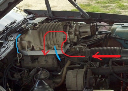

          The problem I see with the tubing setup for the throttle body is that the engine moves. The mounts are down low so the further off the top of the engine the more it will sway when revved under load. Having the TB come off or smack into the refrigerant lines would be a disaster.
          With the charger protruding above the hood line, are you going to use a cowl induction hood? It looks like it would be much easier/safer to make a wedge shape TB adapter to angle the TB up away from the body a bit and then use either a cone filter or tubing with silicone couplers or some other form of flex fitting to an air filter. At least this way if something comes off while testing you don't have your engine revving out of control or any other serious problems. Judging by the mounting plate you made, you have access to the tools and materials needed to make a nice TB adapter out of aluminum.

                from looking at the first pics, i too was wondering about the TB.

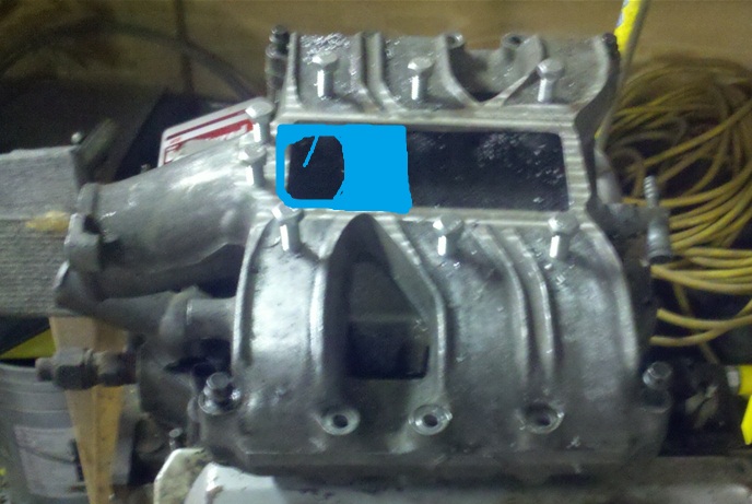

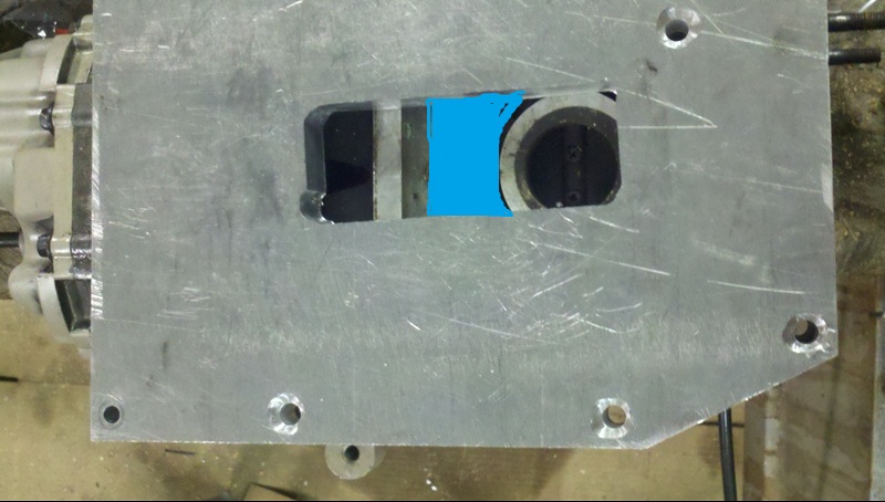

                my first guess was that he was doing away with the BBV and was feeding air to the SC from the stock TB in the original upper/ now lower intake manifold. i edited his pics to show what i was thinking. maybe this idea can work? but it will be at the expense of the BBV.
                it would need a block off plate inside of the old upper intake manifold so that the TB would send the air to the old port for the BBV. then into the rotors then down into the old intake manifold to go to the runners so from the setup he has now the old upper intake and his adapter plate would both need modification now.
                i have seen some cars that cut holes in the fire wall and ran pipe thru it because of the lack of space. i think it was a fox body mustang running a crazy big turbo... and to make the pipe layout clean... they ran a 90* elbow off the carb into the fire wall .... wait it went to an intercooler in the trunk! was a Water to Air IC and it had a big ice tank for it.
                ever think of trying to move the engine mounts forward? or using a northstar TB or other TB that is shorter?
