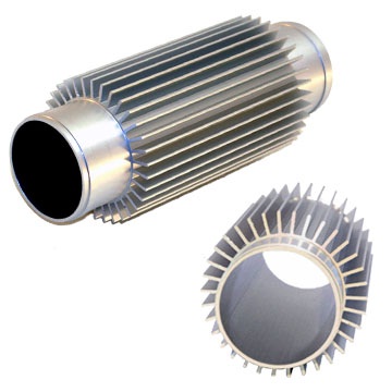

                I considered a zero moving parts cooler built like this.....
                Using this pipe type .......
                And run that in larger pipe so air flow can be directed/forced over the fins. So it would be a pipe in a pipe. The inner pipe carries the intake air charge. The outer pipe conducts heat away. The outer pipe would route to a location where the venturi effect can be maximized, drawing the air from the vacuum created as the car moves faster.
                It would be an interesting setup. If we can create equal surface area of an appropriate intercooler, we should get greater heat removal. AND the hot air is drawn out of the engine bay.
                Of course I still wonder what direction of travel would be best. Conducting the cooling air in the same direction as the intake charge or opposite of each other. One would focus the cooling effect in the beginning and the other at the end.
                The same idea can be used with air-water intercooling. Just use water instead of air and pipe it to a heat exchanger.
                What is great about this idea is the aircharge does not have to be forced through the intercooler as the pipe itself IS the intercooler.
