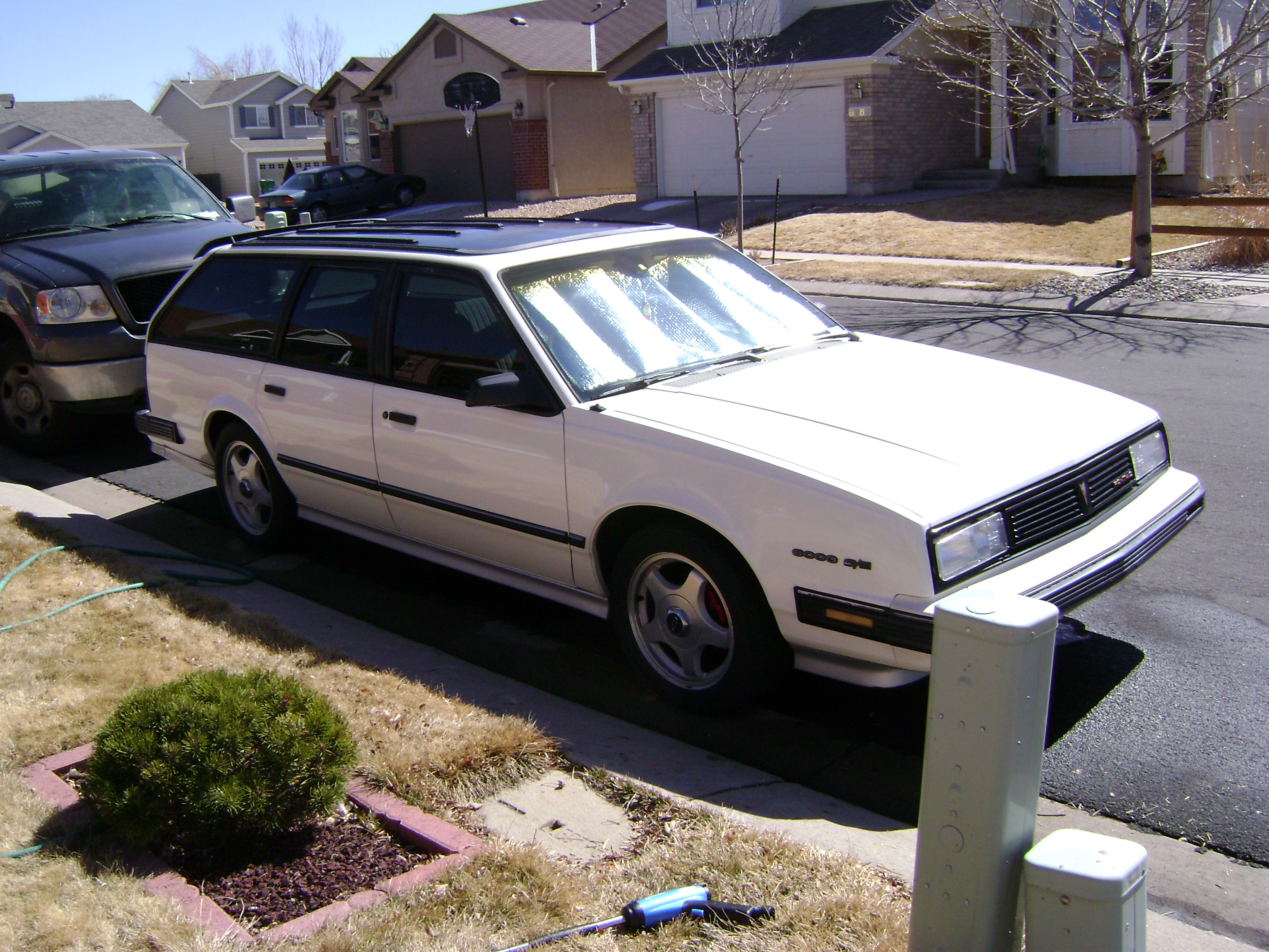

    Hello everyone, new guy here with some questions.
    I have a project I have been working on for way too long and have come close to giving up one many times. It now seems to be finally working out but I need some answers first and I'm hoping someone here can help.
    I have a 1991 Turbo Grand Prix motor and tranny both rebuilt with only about 50 to 60 miles on them. These two reside inside a 1987 Pontiac 6000 S/E wagon. I had this engine rebuild and swap done professionally back in '08 but the car never ran right and the guy closed shop, so I have spent the past 4 years or so trying to find someone who can work on this thing before I give up and crush it! I stored it for a few years too. Anyhow, I found a good place and they just did some work on it to get it running and without any tuning it put down 191hp at the wheels. Now they are in the process of getting a chip made for it but need some information on the cam that was used. The only thing the guy that put it together told me back in '08 was that it was a little more aggressive than stock. Never gave me a name of the manufacturer, grind, etc.. The guys tuning it need that. Any of you guys know of any manufacturer who made cams for these motors? Summit doesn't have any, Comp doesn't make any. I was all excited about this project back then, but after paying a good amount of cash just to drive a car home that stalled every 2 miles, I was not happy and almost gave up and took it to the junk yard. This is it's last chance.. Someone please help me save it from the crusher.

      Actually, today I found a few examples of cams that are sold for those motors and I took the specs to the guys working on it. Hopefully it will help determine what's in there, at least come close to it. As far as the stalling, after I got it back the first time and it kept stalling, I spent months looking for a mechanic who would work on it. I finally found a guy who went through it and he found it had tons of vacuum leaks on the intake, the hoses, you name it - it was sucking air in all the wrong places. So he sealed all of those up and then I was at least able to drive it without stalling at every red light. But it still ran like a pig and I didn't want to damage it by driving it so I parked it for a few years. Now it's driveable but hesitates a bit when you first step on the gas, then it's happy. It also has a few lean spots throughout the rev band that they want to correct. Also the speedometer which was working just fine, didn't work when I got it back.. Two new gauge clusters later - the guy who tracked down all the vacuum leaks discovered that the speedo wasn't getting a signal from the ECM any more. So now that has to be corrected as well. She needs new struts, and the tires dry rotted from sitting all that time. The paint on the roof also has taken a turn for the worse in the last 2 years or so. Other than that, the interior still looks pretty much brand new and everything except one window motor works - even the ERC! It now has an intercooler in the lower air dam area beneath the front bumper. Half of it is visible - I wish it was hidden but, it doesn't look bad. Here's one picture, I hope it comes up. I'll post more when I get it back.
