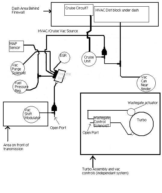

      Here is a vac diagram from a TGP.

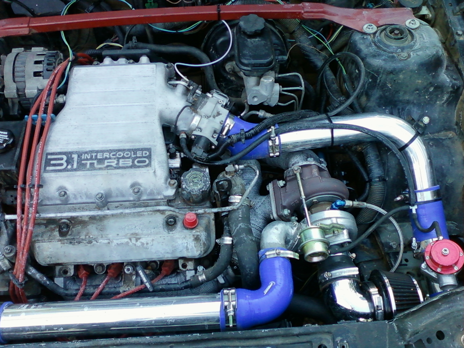

        Let me try this again with the pics.Compressor side of turbo does not have a vacuum port.I thought it was vital to have some things hooked up before or after throttle plate.I probably should drill and tap for a port on custom compressor outlet elbow for waste gate actuator. Click image for larger version

          The way it is now should work. Unless you have boost control issues, I wouldn't worry about it.
