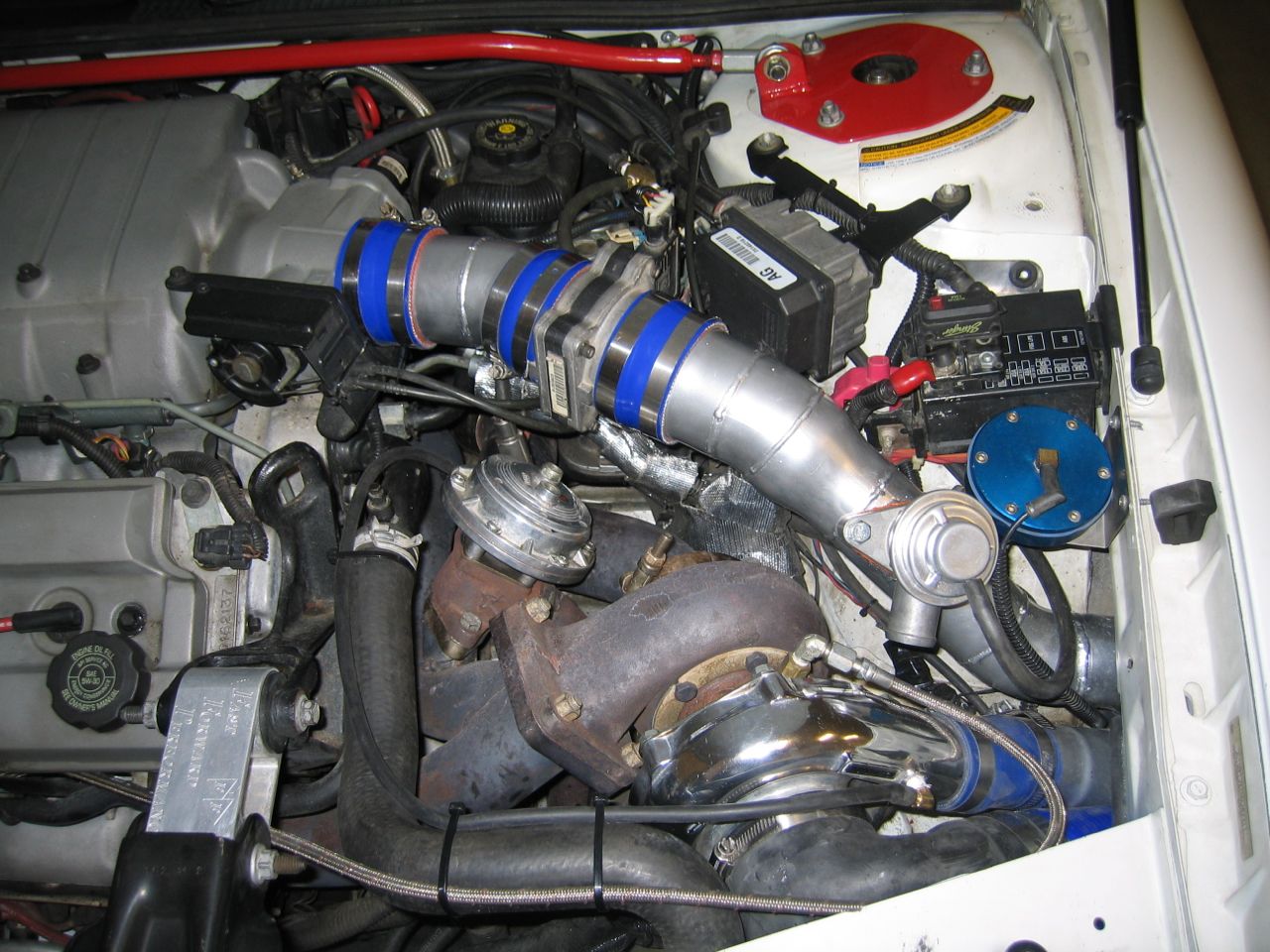

              Here's mine. I'm not sure how far it is, but it works well. I had it after the MAF for a while. The fireballs were cool, but the noise and occasional stalling that resulted weren't... This is a MUCH better way to go.
              Some BOVs are integrated into the turbo, others are right next to the throttle body. There are benefits of each. I would try to put it at least 6" away from the MAF sensor and before the MAF sensor. Other than that, put it wherever it fits.
              Tim

                  Thanks for the input everyone. I would prefer to run a pre turbo MAF, but for now I'm running a post. I moved the MAF a little more than 6 inches from the TB (But it should be ok). The BOV is 12ish inches away from the MAF and is tucked in the wheel well. It's a very tight fit in the wheel well since the air filter, and both charge pipes are in there. But everything fit after some trimming. The car runs great and everything is working, except my wastegate opens at 10 psi instead of 6.. But the BoV seems to be doing its job!

                    No issues here. Blow Threw MAF and BOV is 1.5-2ft from TB

                      Almost exactly like mine, just the head of mine faces the engine. Do you drive it in the winter at all? And is your ET at Bandimere?
