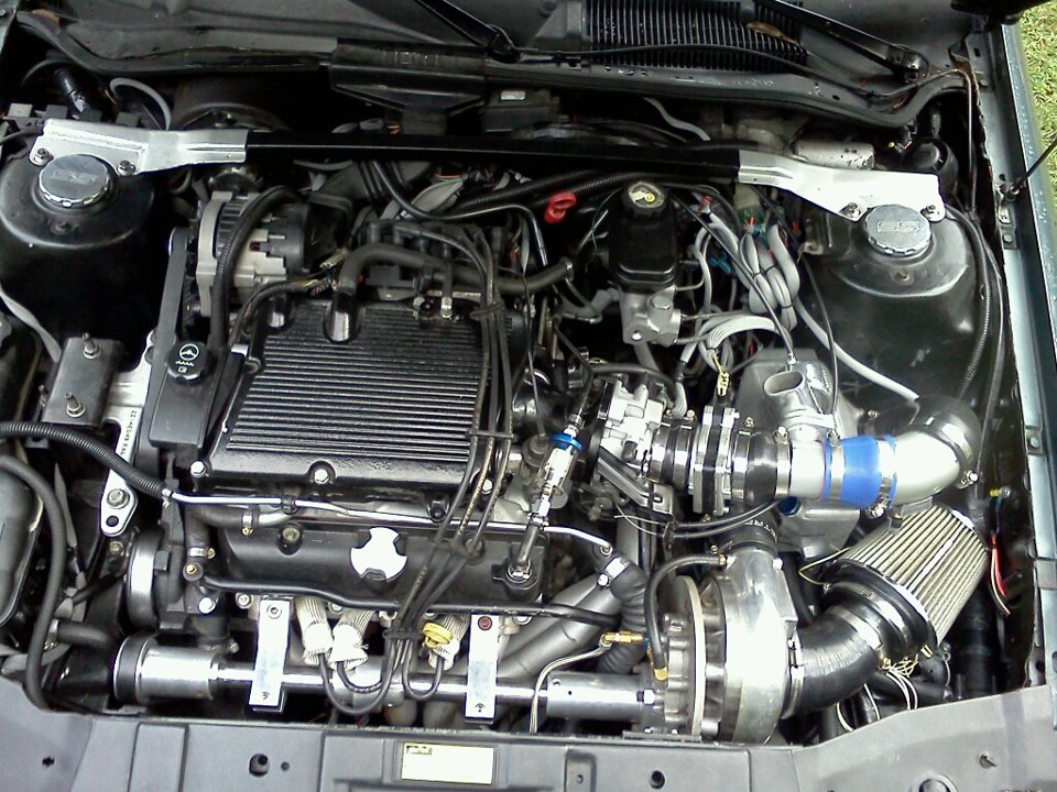

                        Anyway, moving on, constructed a new and improved driveshaft mount and installed my straight shot UIM with transition pipe:
                        And got some runs in at Beech Bend Saturday afternoon. Nice 75-degree day, 7.5 inch slicks, bypassed filter. I forgot to have the tank full, it's been over a year away from the track, so it ran out of fuel near the end of track on each run.

                          I guess if somebody in the community really had to have a set of castings, I could probably do that, but the mounts are just in the prototype stage. They seem sturdy enough, but who can tell what could happen with severe road use. Now if one of the "Big Three" (ha), WOT-Tech, MMS, or BCC wanted to make and test mounts, that would be great, but they're not that interested in this platform, it would take their time and money. I don't have any way to make precision cuts or obtain good aluminum stock material, or even a welder. I can tell you it's nerve-wracking drilling holes in those castings lol. Also, the case mount system will most likely have to be modded for intercooling.
                          You'd have to get the SC from Magnuson Products, then make the mounts from patterns or pics. And also, a 4-inch notch has to be cut out of the hood bracing. Right now, unmounting of the SC requires removing the inlet casting, 9 bolts, and loosening 3 others. You have to do that to change spark plugs 2 and 4.
                          That being said, the effort is well worth it to me. The car made it a good 180 miles loaded down round trip to the track, got beat on, and ran effortlessly, worn-out engine and all.
