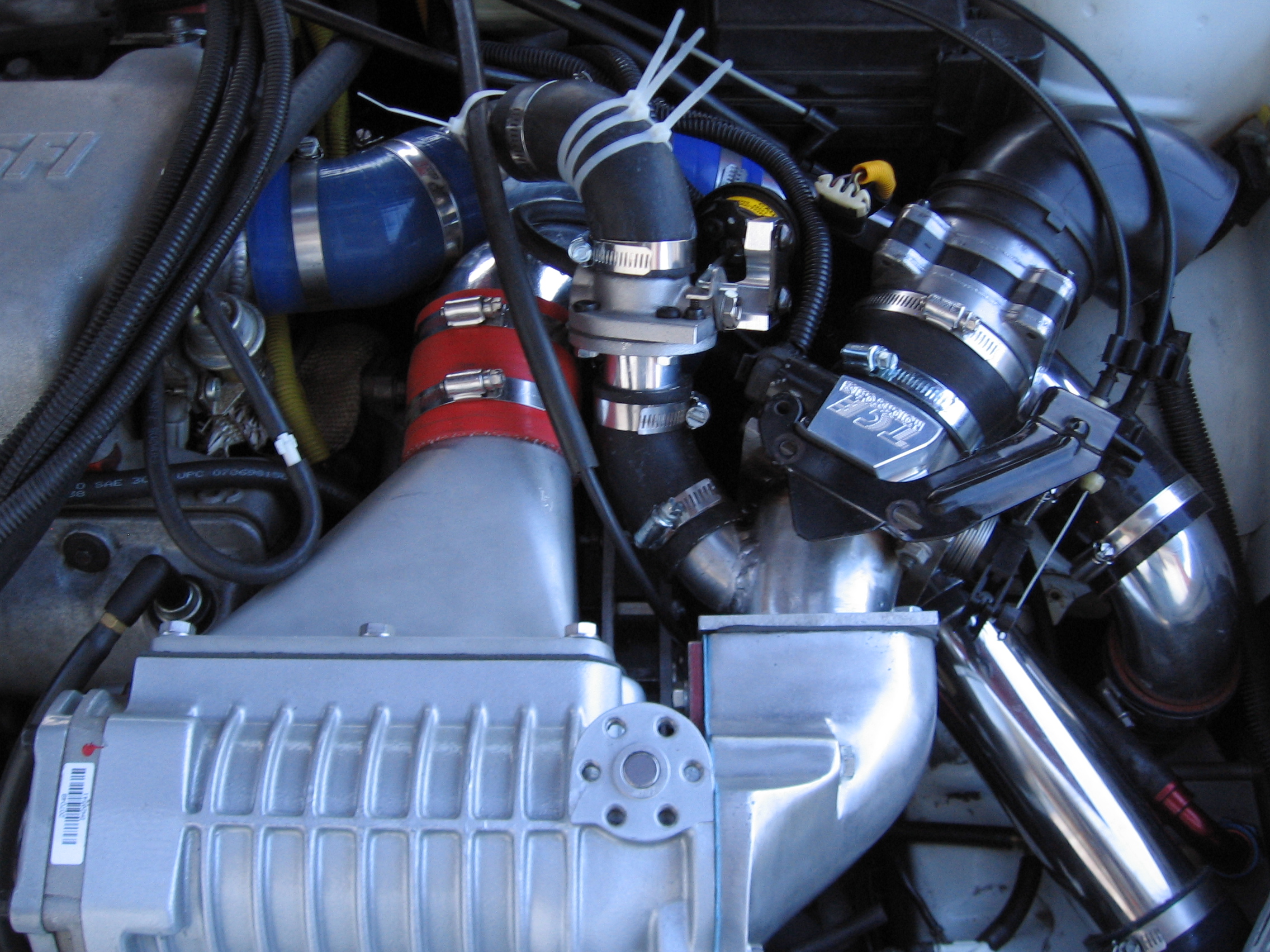

      Can't tell too much there, but got about 1/4 inch more hood clearance. The driveshaft sits about where the one did on Magnuson's original MP62 kit.....
      And here is a plaster mold to make a custom coupler pipe to the UIM:
      Tested the ported inlet/outlets today, and did get a couple more psi boost. Hit 13-14 psi, and over a broader rpm range. Yay

                To clarify, this setup requires the battery to be relocated. The components are currently located as shown:
                Although I have an AW intercooler installed in the fender, the first attempt to use it with the MP 90 did not work. The method and location of the bypass system could not properly react to the pressure changes.

                              Mock-ups!
                              Reconfiguring components for a blow-through intercooled setup. This may be my last attempt at it.
