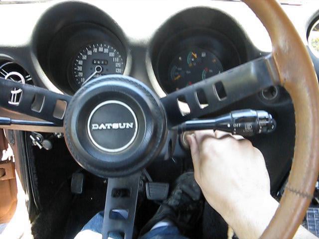

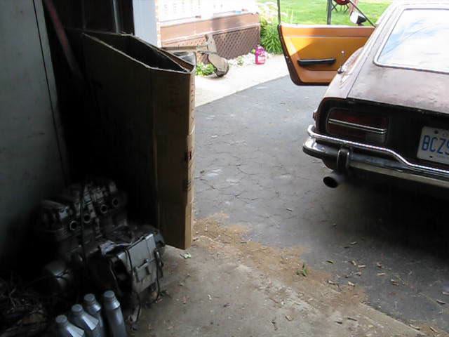

                              I'm running 3" exhaust and a Moroso Sprioflow muffler on my car, while it's a turbo 2.8L, it's not a 660, it's a Nissan I6.
                              I think it sounds good, though I've never heard it from outside the car, at least not while I was still, my boss and I traded cars for a short drive once, and the car has changed quite a bit since then.
                              I did notice back when my car was N/A, that when the muffler pulled out of the old exhaust (It was a quick and dirty install at the time), that I definitely lost power.
                              Many people tell me that I have a grumbly V8 sound, I had one guy on Friday at the track tell me that it sounded like I had an LSx in my car. *shrug*
                              Now the sound will be different on a V engine, because of how the primary end of the exhaust would be set-up, but I'm planning to keep my Sprioflow (or get a new one) when I swap to a V6.
                              Some neighbours think the car is loud, at 8 on a Sunday morning at least, but most people comment how quiet it is until I get on it.
                              This was about 4 years ago and doesn't really do it justice. It's hard to get the same sound on a computer, especially when recorded with a digital (stills) camera:
                              This was a video I took minutes before I started converting it to EFI and turbocharged:
