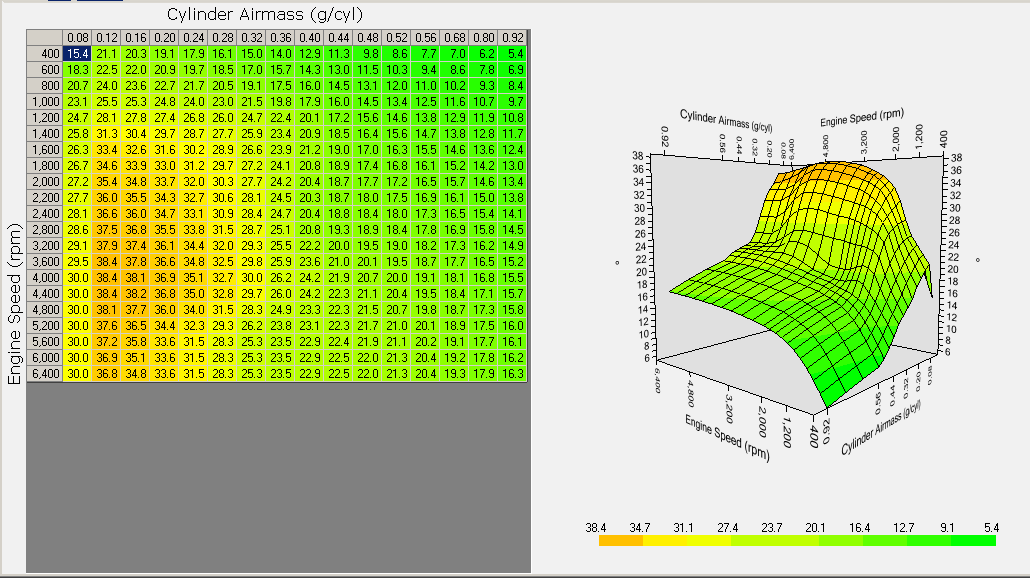

                  Sure do, I'll get them up soon. If you are curious where to reduce spark during spool, it is around 0.44-0.48 g/cyl area. Spark map is pretty much standard until 0.4 g/cyl where it dips and rolls into spark for boost.
                  At the moment, I have all knock disabled until 4000 rpm. This way the spool doesn't trigger false knock but still having knock protection in boost. I could nudge it down to 3600 but a few times the spool is caught and pulls timing when flying down hill.
                  If you suffer from false knock from turbo spool, this does help a little. Or you can reduce the max timing pulled vs RPM. But I found sometimes the false KR pulling only 1 degree can extend into higher RPM from the decay rate. As long as the spark below 0.52g/cyl isn't too aggressive it should be okay.
