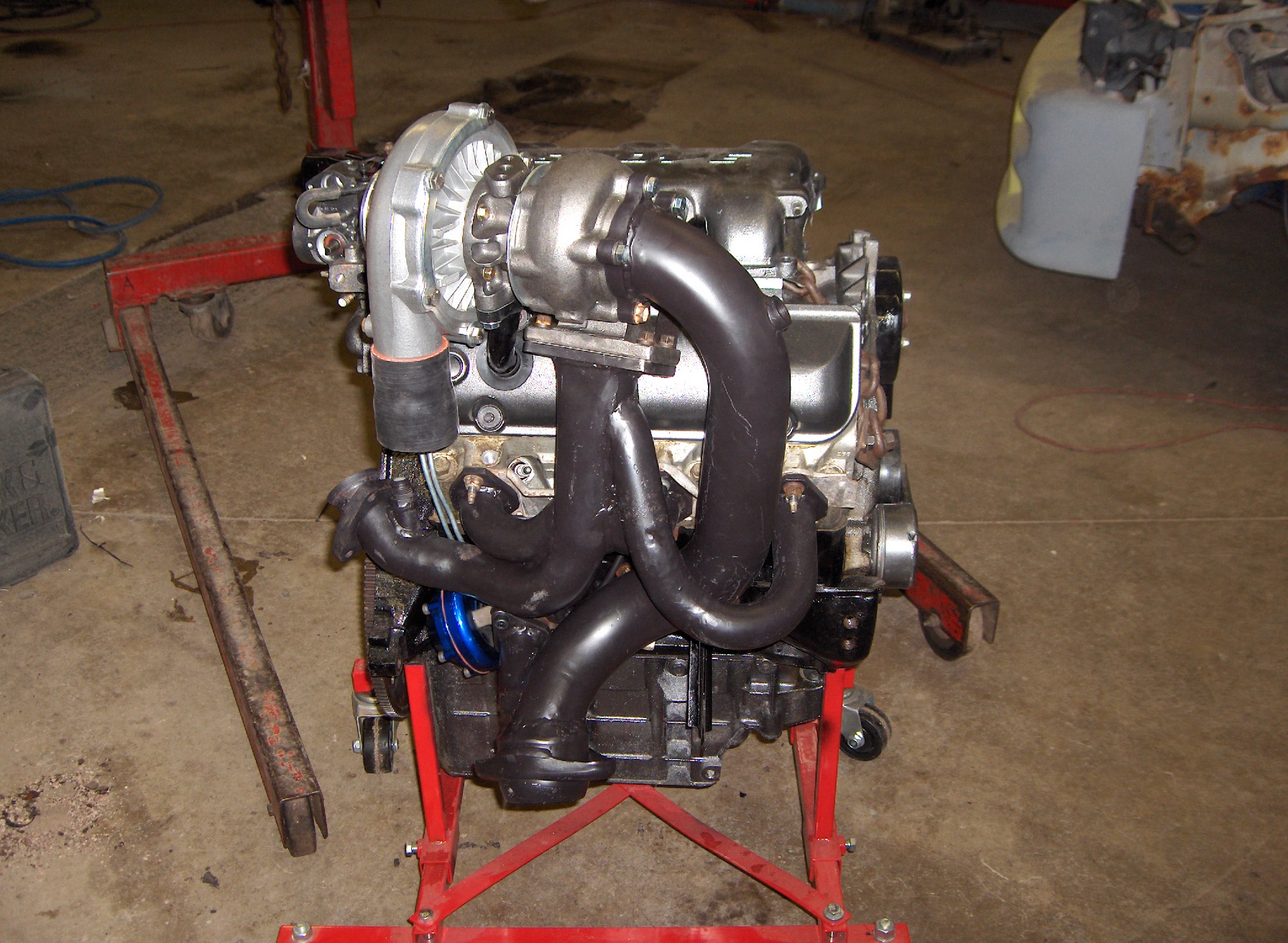

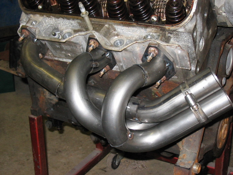

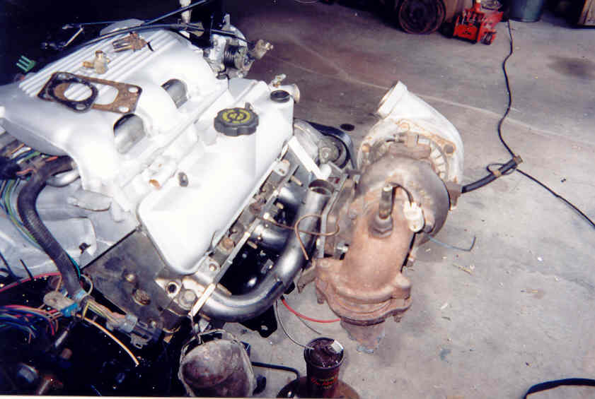

        Just a couple pictures of the headers in the build stage for the Franken60

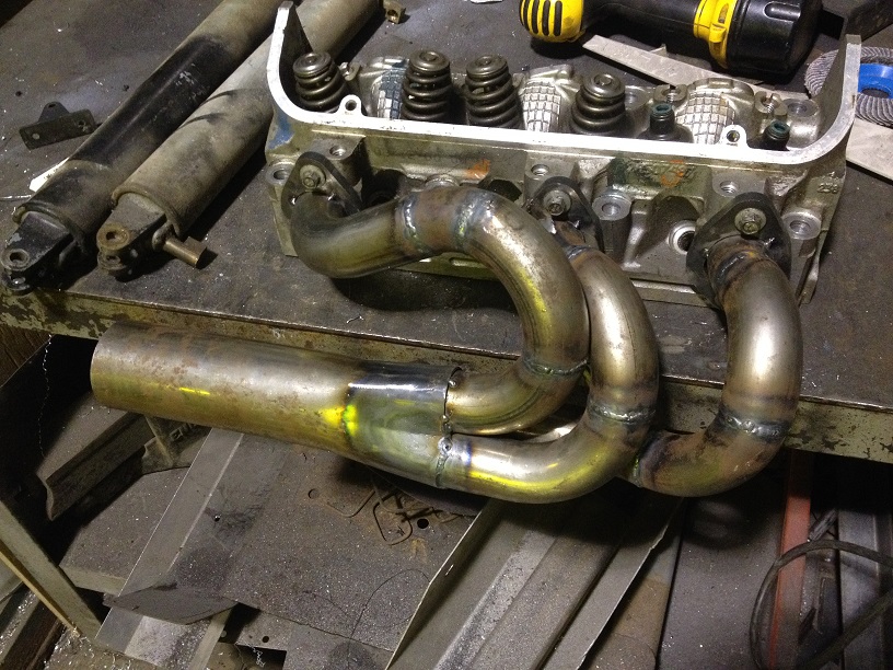

        A couple pictures of the build stage of the headers for the LX9

        Just thought these might give you some ideas.
