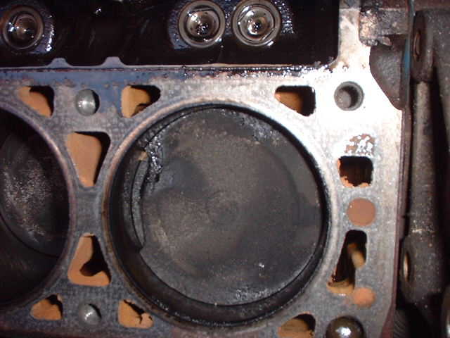

                          The 3.4 camaro pistons are pretty strong and eutectic also suggests that they are stronger than the 80s v6 pistons because I actually broke a ring land on one and it showed no damage to the top of the pistons as you see in these from the 3.4.
                          What happened here on what was a twin turbo 3.4 in a Fiero was a simple mistake, a ground strap was left disconnected and some how it caused the computer to apparently go haywire and excessively advance the timing almost instantly on giving the engine throttle. The damage is extensive but it occured right after the engine was installed and after several brutal detonation cycles audible inside and outside of the car while I was trying to figure out what was wrong. I gave up and decided to convert it to single turbo and during the dismantling process found the disconnected ground strap.
                          I'm also considering now since a mishap last year the possibility of a chip data problem being the cause. I found several hiccups in the spark table of a chip I burned once after rechecking it. It was off by double digits in several places. I don't recall whether I suspected the chip years back when the 3.4 disaster happened, or a may have ruled it out by trying an OE chip.
                          After it was converted to single turbo it ran fine and strong with the pistons looking just like they do in the picture for months. What led me to the discovery was a broken piston ring and more detonation abuse finally cut about a .050 groove in the cylinder wall and boost pressure started blowing oil out of the engine.
                          Amazingly, there was only slight damage to the turbine wheels on the turbo, eventhough they processed bits of piston and piston ring. Only the top of the piston chipped, the ring lands remained intact.
                          The pistons from my 3900 look a lot shinier than those so I wonder what kind of changes they made in the casting metal and if they are stronger yet.
                          Also I have a picture of a 3400 piston from an 03 Alero and noticed that it does not have the antifriction patch so it must be the first design, it also is a little dull in color like the 3.4 pistons instead of a shiny silver aluminum color like the that in the 3900 and most likely the 3500 also. I suspect there is a possible bit of truth contrary to the apparent insistance by MAHL and a GM tech that GM said the pistons in the 3.6 DOHC are aluminum Forged pistons by mistake. I haven't seen any other V6 pistons that shiny and I can't see how they would make them weaker at the same time the power demands are going up.
