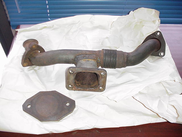

            3100/3400 topend? Here's what you need... it will only work with an automatic, though. I built a 3400SFI turbo and later demodded it. This is what's left:

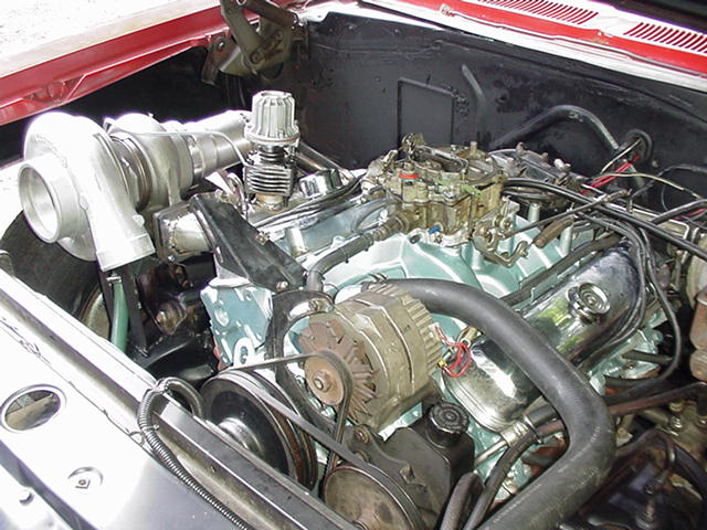

                  A GT28 non-roller bearing can be had for a good price and will flow enough air for 350hp. Or, use a crossover pipe something like I built (in the pics above) and use a T3 .63 a/r O-trim with a T04E Super 60 trim. You should be able to make 250-275whp on 10-12psi, intercooled. Use all the factory piping and intercooler and modify as needed. That intercooler is pretty good.

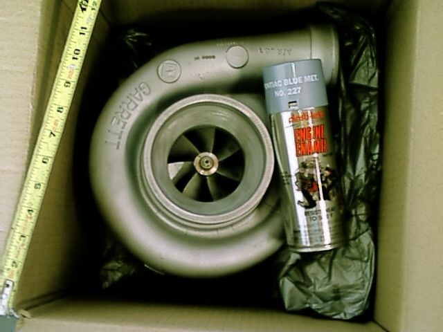

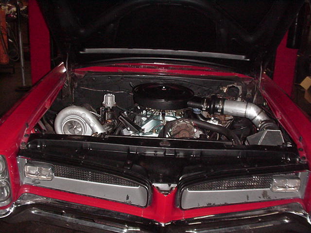

                        Call Tom @ Turbo Resource in Lake Havasu City, AZ. 928-505-5406 He is the best price I have found on rebuilt Garrett turbos. He builds them custom, too. He built this for me... $749.00. Custom "T-88" TV7585 hybrid with REAL Garrett parts. It's on my 455 Pontiac V-8. You don't need one that big! LOL! But he can build a T3/T4-60-1 for unheard of price! Keep the hot side down to a Stage 4 or O-trim and the 60-1 will flow enough air for 400hp at 10-15psi (if needed).
