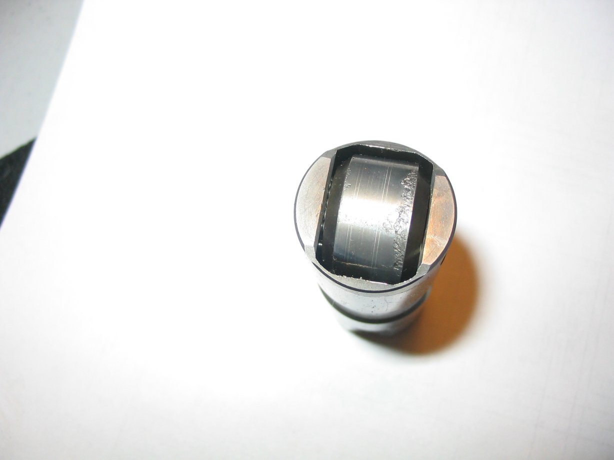

    I need 1 or more hydraulic roller lifters from a 60 deg v6 for an experiment I am doing trying to convert my LC2 TurboBuick engine over to hydraulic roller using as many factory parts as I can.
    I bought a set of lifters from a 2.8L in a core engine at the junkyard with spider and a spider from a 3800 for $20. One or two have some pitting and need replacement.
    Let me know what you have.....
    Here is a pic of the pitted roller.

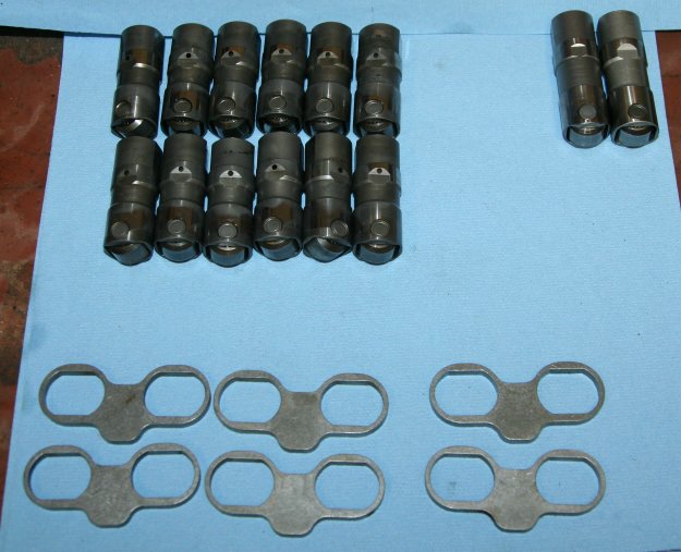

        Here is a pic of the ones I have cleaned up..... one maybe more will have to be replaced due to the pitting you can see in my previous post.
        The taller pair on the right by themselves.... are 3800 lifters.... same as 4.3L and the V8 hydraulic rollers.
        The short ones are the ones I am after.
