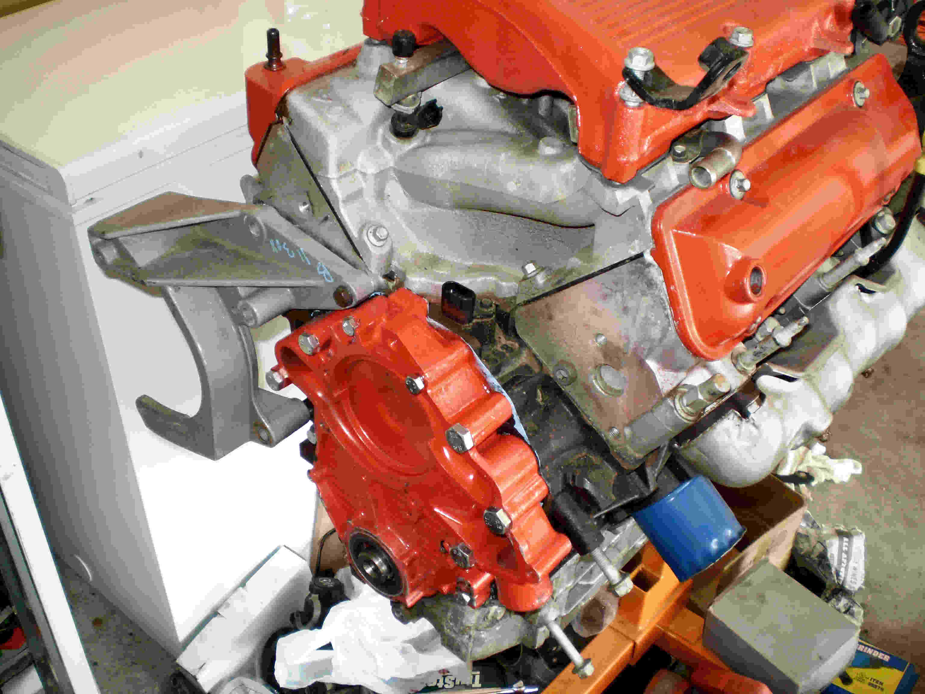

    LX9 Oil flter base as pictured
    Looking for the oil filter base like this. I don't know what vehicles it was found on. I didn't get one with my Uplander engine, filter screws into the block.

                  Joseph,
                  My 2006 uplander LX9 did not come with an oil filter adapter as seen the the enclosed picture.

                    Very strange. I've had quite a few '04~06 LX9s here which all had the same threads as the older engines and I am using a Beretta adapter on my '06 LZ9. What year is your 3900?
