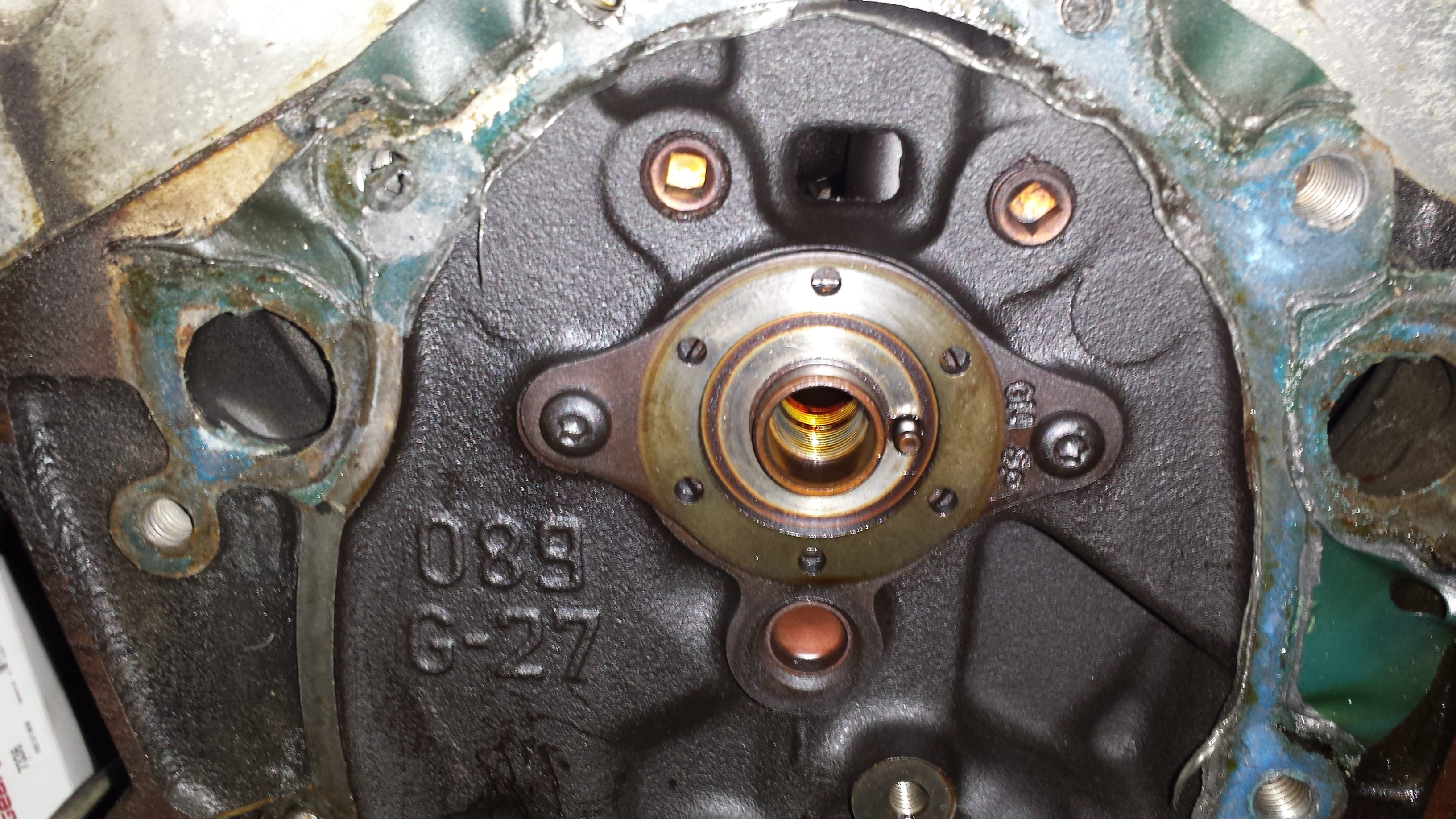

                          on the note of oiling issues, it might not be a terrible idea to drill(and debur) a couple of small oil holes in the camshaft retainer plate so that there is plenty of oil flow to the back of the cam gear where the oil slots can sling it to the chain. when my car is in my hands again, i plan to do just that.
                            #343
                            It already has 6 holes...

                              #344
                              [ATTACH=CONFIG]7828[/ATTACH]
                              whoops! been a while since I looked at mine, I didn't remember any holes.
