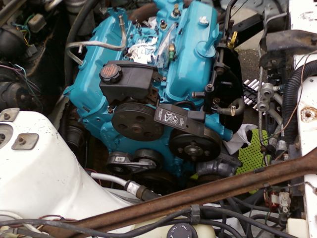

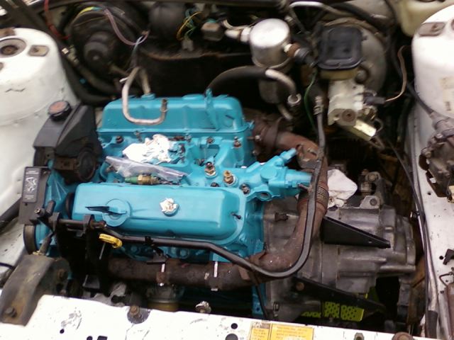

            maybe post a pic of the engine bay?
            Dis isnt very old school, but all to your taste

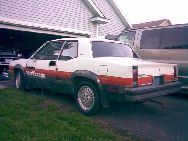

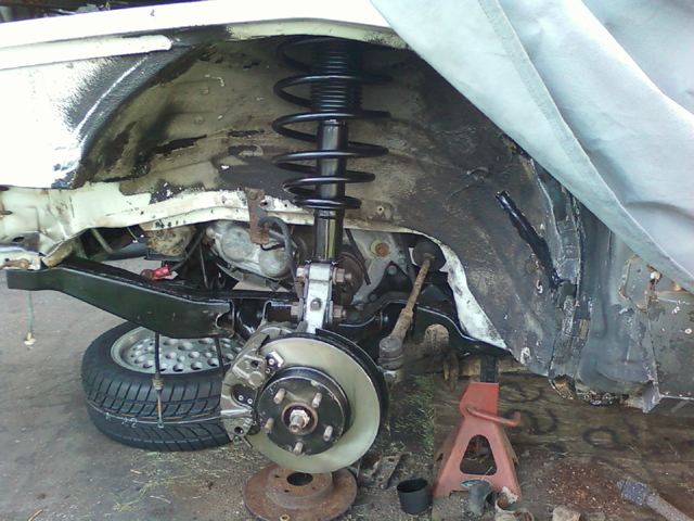

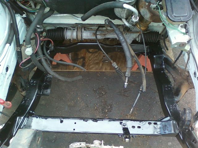

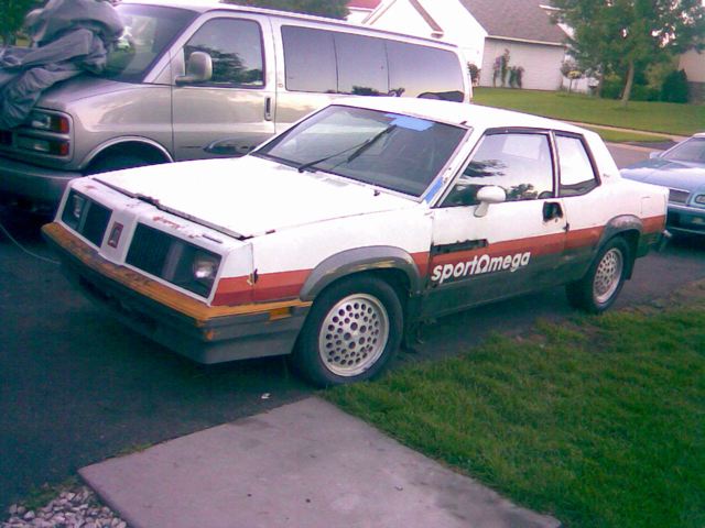

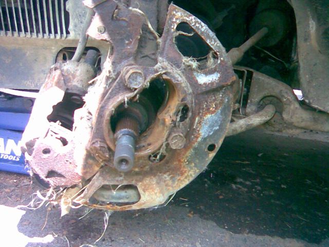

              Here's a few more pics of the car. It had a tough life, check out the pics of the wheel bearings/spindle (the before and after). They drove it until it almost ground another hole in the spindle, it kinda looked like a figure 8 hole from the back side. I saved those pieces for the wall of shame and for whenever I finally get to take it to a car show. It does look a lot cleaner using the serpentine belt setup as opposed to it would've originally came with the long water pump/v belt front accessory drive. I had to rescue it after finding out they only made 696 of these Sport Omegas. It has its own unique piece of GM history as thevery first GM vehicle to use plastic body panels, the front fenders and rear flares are made of it. It's going to take a little reconstruction to repair the rear flare it's missing a section on the bottom.

                Looks like you already have good progress
                And good god @ the hole in the spindle!
                It looks like its carbureted. Am I wrong?
                You own a rare piece of oldsmobile and just think of it this way:
                You will be the first ever 3400 swap into an omega! You already have the lower end in it, so thats a plus.

                  Well it is a 3400, but in order to swap to iron heads I also had to swap out pistons from a camaro 3.4 to maintain a decent compression ratio. Otherwise I would've ended up with a very blower friendly 7.5 to 1. Working on repairing the plastic fender is a lot more challenging than metal. The whole drivers side was swiped, probably because the wheel bearing was so for out of alignment they finally lost control of the car. The other stupid thing they did was they yanked the original 2.8 and had stuck an Iron Duke in it!!!??? It was just a mess. Oh, and the floorboards are toast. I love my plasma cutter and welder, grinder, spot weld drill bits. etc. If you think about all the money GM spent on tooling to make the special items for this car only to sell 696 of them. The molds for the fenders, rear flares, rear spoiler, urethane nose and all the related parts (regular Omegas had a aluminum front bumper/abs plastic header).

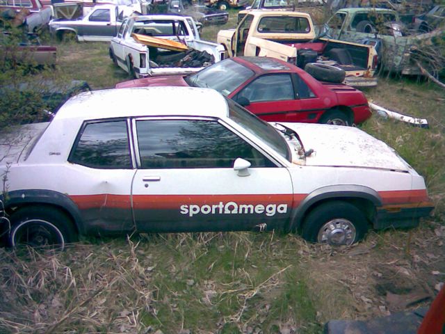

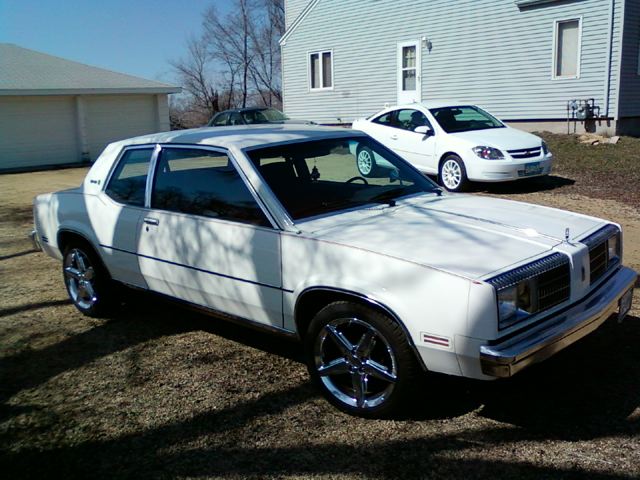

                      I like it too, but only the 80-81 models. The 82-84 had tail lights that were more square and didn't peak just over the to of the quarter panel like mine does. I'm also trying to find a factory tach, but I don't think I'll find one. I've tried a dealer to get a part number but the parts book shows it as an item serviced by Delco as many elctronic parts were back then so the book wouldn't show a number. Kind of dumb, it has to have a part number to start with. There is one more of these cars now in the Mpls/St.Paul matro area. A guy I haven't actually met yet but I've talked to on the phone and email bought one of these cars after I turned him onto it. Actually I had left him my phone number on his 81 Omega Brougham 2dr. I had seen on my way to one of the local u pull yards last spring. FYI, his Brougham is also a 4 speed car. Here's pics of his Sport Omega and his Brougham

                            Thanks, yeah just the tack is all I'm looking for. It's too bad the polycast rims Todd has on his Sport Omega were'nt 14 0r 15's. I know 13" tires were the norm on these cars. They do look good on the Sport.
