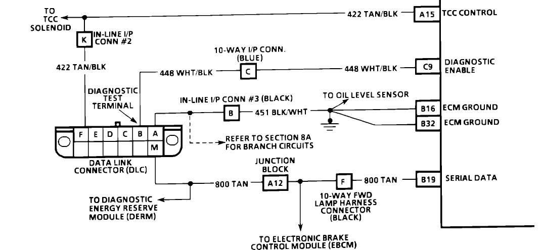

    I'm looking for help please.....I have a 1994 Firebird 3.4L that we are racing in a novice class on an oval track. The car needs to remain virtually stock. My problem is the car was completely rewired and I'm reinstalling the diagnostic plug for the scan tool. My PCM is #16184737 - from a PCM diagram that I do have which I believe is from a V8 Camaro (see link - http://www.v6f-body.com/showthread.php?t=689 ) Someone told me that I only need 2 wires - "A" and "M" of the diagnostic plug? I've done that but still have no communication between the scanner and the computer. I have direct leads running to the PCM - "A" going to "B16 & B32" ECM ground and "M" going to "B19" Serial Data. Also from that diagram on the link, I don't have an "F" lead from the diagnostic plug but one coming from the pin below which I think is "G" (black/white) which I have no idea where it is supposed to terminate. There is supposed to be a diagnostic enable wire on the PCM on a diagram I have that says its on C9 but I have no wire on this pin on my PCM #16184737. So in a nutshell - how do I rewire in my data link plug - like I said it's a race car with with only the components necessary to run.

      Does this help? And sometimes the scan tool will attempting to use ALCL term. B which is not used on that model.

              I spliced the M & B leads together but still have no communication. I noticed on this scanner that unless I continually hold down on the power/on button it will shut off. The mechanic I borrowed the scanner from said I don't have 12v at my data link plug to keep the scanner powered up. I've attached a diagram of a data link plug I have (it matches mine except for pin "F" - I don't have anything wired to "F" but have a wire directly below it which I didn't see marked - would it be "G"? Anyway I only have "A" and "M" wired to the computer. I have also tried adding "M" where "B" and supplying 12v to what I think is "G" - still no communication - I only have 4 leads coming from my Data link plug. Do they all need to be connected? Like I said I'm new to this.......Thanks

                ALDL term. G is usually for ABS diagnostic as I recall. In any case, To power up the unit you would need the power adapter cord. It would have an accessory plug to plug into the cigarette lighter and the other end plugs into the ALDL adapter on the side. If the cigarette lighter is inoperative, there is supposed to be an adapter cable that has battery terminal clips on it for the power cord. You can probably find one at Radio Shack if your buddy lost his. Wire up according to your schematic, all the way for your application. Then get the scanner powered up and we'll take it from the top.

                  It's a race car....no cig lighter, ABS, most everything has been removed for racing. If I hold down the power button the scanner will stay on. I currently have my data link plug wired per the schematic - "A" to the ECM ground pin "B16 & 32" and "M" to serial data "B19" - hold down the power button, put in the car's information select read codes and the scanner says no communication. Also wired "B" of the data link plug with the "M" lead with the same result.

                        No, it is not necessary to ground the case, often they are in plastic retaining brackets from the factory. Does the check engine light operate properly? i.e. Does it turn on with the key and go out after start? Further, you are probably not wired out from the PCM for a lockup converter so F was not installed to your ALDL . . . . ya'll aren't on stock automatics, are ya'? Does the broadcast code on the case sticker agree with the broadcast code on the prom sticker? Or, is there a Hypertech stuffed in it? Tell ya what, how about a picture of the open PROM bay on the PCM, that may help to decipher why you can't establish communication. Believe it or not, it may be that you are simply using the wrong year code when you entered the tenth character during vehicle ID. Or, maybe there was a different body code (third character) or engine code(eighth character). Is this the original PCM to the car? That service number comes up good for your car when I plugged it in at O'Reilly Auto Parts' online cataloging.
