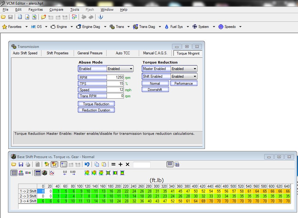

    Max pressure says 90. I was planning to start climbing +1 for each field and see if it behaved good/bad so on. If 90 is the max, what a safe max for the chart? Also do I need to modify any other tables prior to flashing?
    Also with Abuse mode. I believe this mode is enabled when putting the car in gear. It feel like it's a really hard shift/slightly jams into gear making a clunking like noise. Either way it's very aggressive. There is a complete lose of power above 4000 RPM and from 2500-4000RPM (under moderate acceleration --- maybe 30-50% TP) it'll jump like the clutch is engaging and disengaging. If you run it 100% it will have little to no power above 4000 RPM and hit the rev limiter and not shift until you back off the gas.
    Does that sound like what abuse mode does and if I disable it will that stop it from doing the above behavior? Or is there something else I should worry about?

      Disabled Abuse mode and still the same stuff.
      When it happens it appears I get [PCM] P1810 - TFP Valve Position Switch Circuit.
      I found a stock tune for a 04' Grand AM GT /w 3.29 gears (mine is from a 05'). I'm guessing it might be a good
      idea to copy all the details from that over. I notice considerably higher numbers on several of the tabs. The
      shift pressure is also higher +1-10 except on 3-4 shift it's a bit lower until 100 ft/lb.
      I'll give that a shot (it's going to take a hour just to change everything ----) however, I'm unsure on the
      drive sprocket ratio. The Stock tune shows 1.000 and I have mine @ 2.930 (per lit I read online saying that was
      the final drive ratio on the trans.) Should I just set this to 1.000 since the stock tune shows it?
      EDIT: looks like you can save and load so that's cool
      Thanks!

        Seems to be worse after. Odd. Maybe it's a fluid issue. It seems like it doesn't want to shift and once it does
        it shifts real hard. Maybe it's having a hard time building up the pressure?
