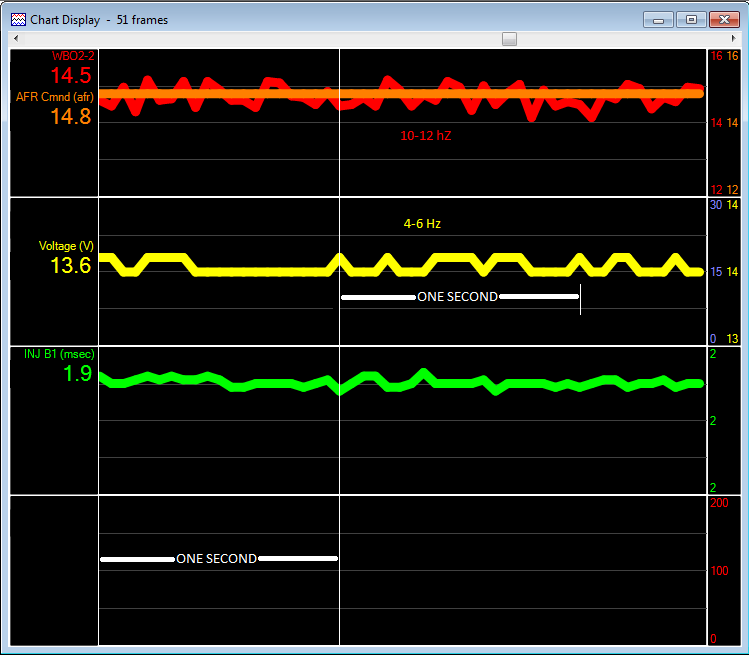

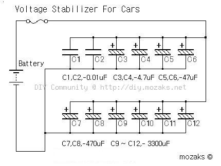

          I can see a triangle wave in the voltage via hpt scanner. It appears to be 4-6 Hz but I'm sure there are many frequencies involved. Since I don't have an oscilloscope I'm probably going to build a diy capacitor board to filter and smooth a broad range of frequencies, if that is possible. I did find a diagram online, posted below, of a multiple capacitor circuit for broad ranges. But when I run it in a circuit simulation it gives me an open loop error.
          You'll see the voltage difference isn't much at all. I'm thinking a host of frequencies are dashing along my power supply. Making the wideband reading a bit jumpy. Maybe I am looking at the wrong approach? How about using zener diode(s) approach?
          This is what I logged with only 6 pid's loaded (best resolution possible).

          And this is the circuit I found...

            the diagram looks to be functional.... i wouldn't have any idea on what kind of frequencies it would filter, but i don't see any kind of flawed connections/etc.
            i'm not so sure i would use zeners(or any other kind of diodes) for something like this...
              You need a real oscilloscope to see what's going on although there is always going to be a voltage variation in a system running on an alternator. 13.6-14.4V depending on RPM and load.
              Your variation on the wideband looks normal, that's just the exhaust pulses passing by.

                Interesting about the exhaust pulses, I thought the voltage variation was partly the cause. That explains why it levels out at higher rpms.
