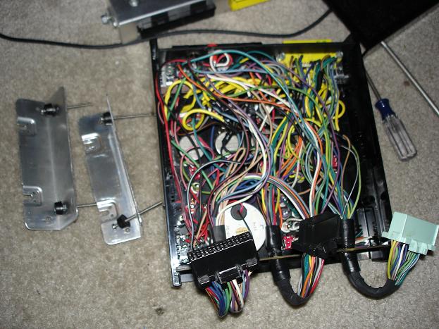

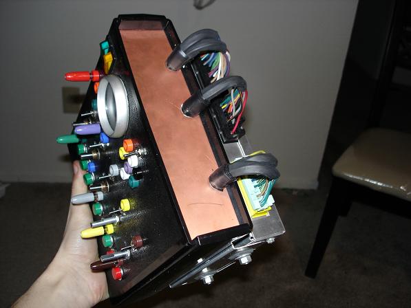

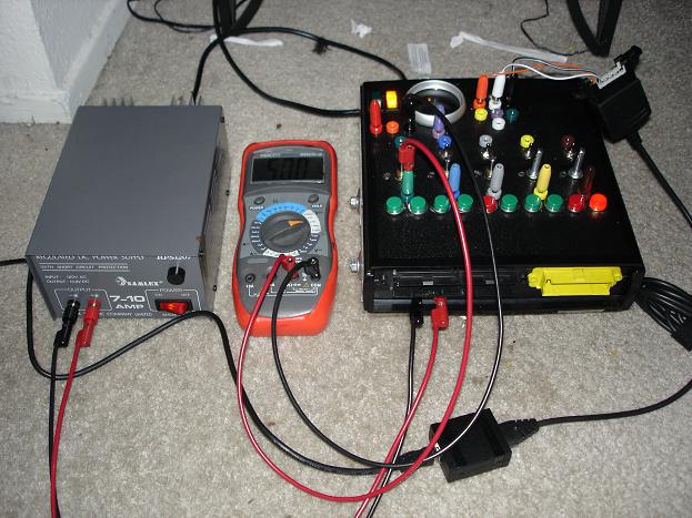

    I made a lengthy post about my testbox at Quad 4 forums... figured I'd share it here.
    I invented a diagnostic device, it's probably the only one in existance like it. I have seen simular devices, but I believe mine is the only one that is an inline unit meant to work with or without an engine, or harness for that matter. best of all it can help do diagnostics on harnesses too. Basically it consists of indicator lights, potentiometers, switches, test points and an A/F guage.
    The 5 potentiometers control:
    MAP (green)
    TPS (blue)
    AC PRESSURE (grey)
    CTS (yellow)
    MAT/IAT (brown)
    Colors were assigned based on the color of the input wire, that way I can remember
    There is a 3 position switch above each potentiometer, and a testpoint above the switch, and one below the potentiometer. The testpoint above the switch goes directly to the input from the wire harness that can be plugged into the bottom of the unit. Putting the switch in the up position sends the signal from the harness to the computer, just like normal operation. Putting the switch in the middle position kills the connection to the computer. Putting the switch in the down position hooks the computer up to the potentiometer, witch is also hooked to the testpoint below it. This way you can probe your harnesses input, adjust the potentiometer to match that value, and then switch from your harnesses input to the potentiometer hopefully without the computer recognizing the difference, or the switchover. Pretty neat eh?
    The lights are all digital outputs (Injectors, Fuel pump, Coolant Fan, Canister Purge, AC compressor control, Shiftlight/TCC Solenoid, and Check Engine light) I still need to add the switches for the digital inputs. (AC request, Power steering pressure, 2nd gear sw, 3rd gear sw, P/N sw, and Brake sw ect...) But the wiring inside is getting pretty wild as you can imagine.
    I use an external power supply to turn on the unit, but plugging it into a harness will provide it with it's power as well. Infact you can turn the car on without the key by turning on the power switches. (one for memory power, the other for IGN) Of course the car will not start without the key still.
    The ECM mounts to the back of the unit and the unit has the pigtails from a harness that plug into the ECM. The wires run straight through (with a stop at some switches and potentiometers, lights ect...) to a set of sockets that plug into the cars wiring harness in place of the ECM.
    Iv'e even gone as far as to create accessories for this unit, although they are far from complete. A speedometer, a tachometer and an ALDL connector.
    The ALDL connector might become a permanent part of the unit since I use that part the most. I'm finding this unit to be absolutly indespensable for helping me hack out the ram section of the program, witch is the key to understanding all the tables and charts. Overall this unit cost me a couple hundred dollars to build and several hours in my favorite electronics store, then I had to build it. I guess I get to name it too. I'll call it the HAXBOX.
    I have registered my copy of EFILIVEv4 and have utilized the heck out of it. It helped me send all the ram addresses to the ALDL and analize the contents with the ECM running.
    Since that post I have added the digital switches and indicators. The wiring inside is unbelievable. The unit seems to work quite well in the car, switchovers are seamless to the potentiometers. I'm finding that Temperature inputs on the ECM, while not designed for 0-5V input, accept that input every bit as well as a 0-5V input does. If I were to do this one over, I would not have based its design on the cars inputs, but rather all the inputs and outputs the ECM has, In other words, 8-9 potenitometers. and a few more digital inputs, and lights for ALL QDM outputs. I would also have liked to make it smarter, having a DIS simulator (reference pulse generator) a VSS generator, and an IACV position indicator, though my ALDL does that for me. One of the cool things Is I have two lights hooked up to the injector outputs, Iv'e had those lights lit solid bright, they barely light up at an Idle
    This unit has been Absolutly indespensable in respects to testing code modifications, testing inputs, and especially modifying data streams; All in my living room.
