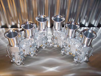

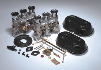

              • Ortie666
                • Jul 2005
                • 340
                By far driveability is key but this is a sand rail were talkin about, and the pictures of the tripple barrels are very tunable even with a big cam, and being that there is one for every cylender it would be just like fuel injection.. the olny reason that a big cammed engine can't run smooth at idol if it has a 4bbl is simply because the outside cylenders have a tougher time tuging on the carb than the inner, hens the surges, and because they dont make a whole lot of vacume at idol compared to a stock cam.. but my v6 has a 4 bbl on it and it has great drive ability, under 2800 it gets awsome gas milege and juss chugs away w.o making a whole lot of noise.. above that it comes into peak performance, and the exhast opens up (gets loud and raspy) and the tires start to spin untill the top of 3rd gear.. on normal pavement..(not rubbered up stuff)
