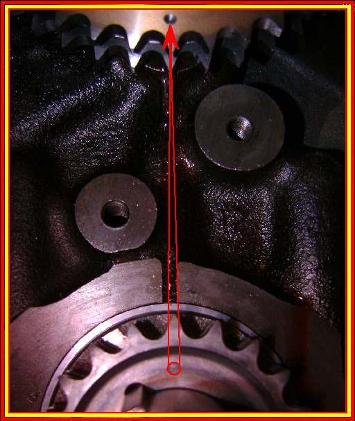

        The cloyes timing set cogs look gollywogged
        Max... Welcome Home...!!! "Teek"
        (It's your Ol' Buddy... --==Bob==-- )
        Like you... I don't know Car Parts from Cow Paddies about the GM V-6 Engine Tuning side of things, but I've just looked over your photo-bucket images and saw something disturbing that caught my eye about the alignment of your Cloyes "True Roller" Timing Set. Without knowing whether you've re-done anything to your motor since those tear down images were taken, ...it appears that your Timing Sprockets are misaligned by at least one tooth...with the Small Cog on the crankshaft being off-set by one tooth just left of center and not being at "12 O'Clock High" and in line with the Big Cog Marker at "6 O'Clock Low". Call me crazy here... but if the engine is running a little ragged and unsteady, power-wise, beyond what you'd expect from the normal lope of your CompCam... (Better make that "Forced-Firebird's Killa-Kamshaft") with the CompCam Roller-Tip Rocker set up... wouldn't this discrepancy help to explain the problem? AFAIK... The Cloyes key ways are pre-set between +4 Degrees Advance to -4 Degrees Retarding...and according to everything I was able to determine before installing mine... the GM setup does NOT require any tinkering with A/R to make it work correctly with the CompCam 260H Camshaft. With no "Tuning" insight... Am I right about the idea that being off even one tooth would cause the problem here, guys?

          That could very well be an issue, and I agree, it looks like it is off by a tooth. Nice eye, Bob!
            Why...Thank You, Sir!
            Max and I are old friends from another forum... and we have worked on similar problems going back over almost a year, specifically covering 4th Gen F-Body Engine related stuff . I think that was the only reason I spotted the problem!

              Thanks for your concern, honestly. That was a picture i had taken so that i could verify that i had it in the "wrong" position. I did end up moving it over a tooth or two and got it correct.
              Just trust me that this camshaft is the main problem (aside from the injectors)

                  Thanks for your concern, honestly. That was a picture I had taken so that I could verify that I had it in the "wrong" position. I did end up moving it over a tooth or two and got it correct. Just trust me that this camshaft is the main problem (aside from the injectors)
                  Same here...Max...! You are finally among "Friends" while visiting this place...
                  Whew... I'm glad its NOT the Timing Set...since that involves so much more to get to and fix. But as for the camshaft issue... Have you got a scan or a photo of your Grind Card? It might be interesting to see what is so "Radical" about it on paper....and then let the "Tooners" have their way with the numbers and see what's what.
