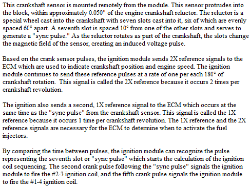

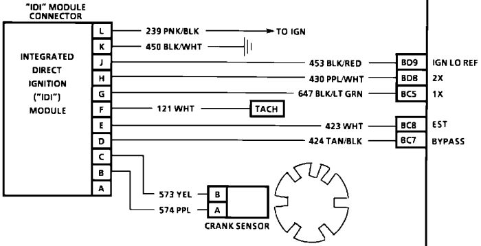

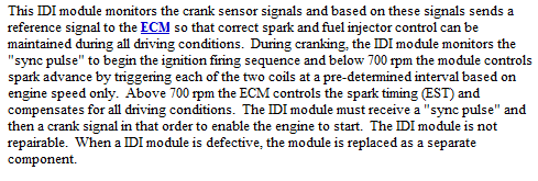

    it seems the Q4 ICM sends 2 signals to the ECM, a 1X and 2X signal, with the 1X being triggered every time the 7th notch(the 1 that's 10* apart from the rest of the 60* notches) AND the 2X gets sent at the same time as the 1X plus again when the crankshaft has rotated 180*.
    now the 2X is no problem at all since it operates on the same principle that the 60V6 ICMs do. the 1X may be a challenge though.
    now, what gets me is that the Q4 ICM makes more sense than the 60V6 ICM. how? because it sends a seperate signal to the ECM for it to determine both engine speed AND crankshaft position. the 60V6 ICM just sends a 2X pulse, which can't be used to determine crank position as far as i can tell, since the ECM wouldn't know the difference between the unique slot and the opposite slot. the ECM shouldn't need to know this though, since it doesn't directly trigger the spark, it uses a signal sent to the ICM to determine spark advance, which already reads all 7 slots on the crank wheel and knows which cylinder is where.
    .................actually now the 60V6 ICM does make sense now. now to figure out why the 1X signal is necessary for the Q4... alldata says it's used to determine when the injectors are fired. i wouldn't think it would matter being MPFI.... unless it's bank-fire(well, for a 4 cylinder, let's call it pair fire), not batch fire.... that would explain the two different injector drivers.
    the firing order is 1-3-4-2 though, and the injectors are paired 1/4 and 2/3, neither of which fire in succesion to the other.... unless that was intentional.......

                        okay, would the ECM possibly work with that for a 1X, assuming the tach out was a 1X signal itself?

                          I'd have to see what these "1x" and "2x" signals are.
                          Can you post the documents that you have?
                            these are all the important things i could find...
                              in reality the ECM/ICM doesn't actually need all 7 notches, the engine would run fine on 4 (3 for cyl position and 1 ref for RPM and timing adjustments). The other 3 are probably just there for resolution. I think that's the 2x signal you are talking about.
                              I think if we could find the schematics for the Quad 4 ECM and a pinout for the connectors this could happen fairly quickly. I still have my '7730 test bench so i could test things if needed.
