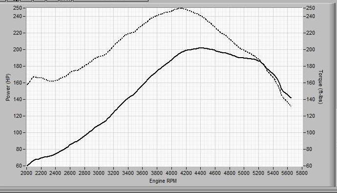

        Thought I posted it here before leaving home the last visit but I guess not. I did 3 test runs with the GTech module installed before taking down the old turbo outfit for a baseline to compare to after the revamp and also to see what effect advancing and retarding the camshaft to full stop would do. For starters I watched a video of track testing of the module to see how accurate it is conducted by the creator and by an unassociated customer who compared the Gtech results to the Dyno results for his car and the numbers were staggeringly close to actual test results, so it is a very good measure of performance.
        I did 3 runs, 2 with the cam fully advanced yielding an untuned best of 202 hp @ 4305 rpm and 250 lb/ft @ 4108 rpm to the wheels on 7 psi. It's actually more because I under estimated the vehicle weight by more than 200 lbs when I programmed the module. The GTech also does net readings which are typically lower than Dyno readings. As you can see by the rpm peaks the engine was limited from its maximum power levels which should have been around 2000 rpm higher as a result of the cam position.
        With the cam fully retarded power was miserable, 186hp @ 5388 rpm and 197 lb/ft @ 4729 rpm. So as CNCguy suspected sometime ago there is a happy medium neither of which lies at the positive and negative extreme. I would say the best you could get out of VVT without the OE PCM is to do what I did, set the cam stop to the proper install degree angle for the cam which is 112 deg for my cam and allow it to advance from full advance or near full advance to pick up a little extra bottom end than what you would have if you locked the cam at the designated lobe centerline. Note also that the non VVT engines usually produce more power than their VVT equivalent such as in the LS series motors. In other words anything more than a simple on off cam retard would be a waste of your time. The 3500 VVT and non VVT don't count because they have different strokes.
        I expect to see numbers above 300 at the wheels with the cam at the proper angle especially since I measured 20 deg advanced which has to kill peak power possibly to the tune of 1000 rpm loss per 10 deg advance which makes sense given the corralation when you add 2000 rpm to the hp peak.

        Desktop Dyno is also close to the output numbers when you look at the corrasponding rpm points although it shows the peaks arriving at a higher point. I'm sure if it had been tuned it would have put down a bit more but I recall being a bit conservative up top with the spark table.

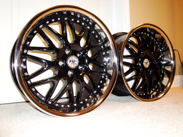

          Thought I'd let you guys get a peak at the wheels, 18x8 and 18x9. The car will be getting a gloss black paint job once the engine is done. I figured if I'm going to do it I may as well finish the forged build with lower compression than I intended and get the car painted last. I can come back later with a thinner Cometic head gasket to get my compression up close to 11:1 and will not have to remove the engine from the car to do it. It will be lowered about an inch or so and I will be keeping the front mount intercooler.
