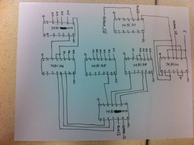

                interesting thought: on a 9396 there already exists on the board an address decoder that breaks the addresses down into 2KB blocks.... the one occupying 1800-1FFF is used by the SRAM though.
                but the 800-FFF, 1000-17FF, 2000-27FF, 2800-2FFF and 3000-37FF blocks are free..... that's 10KB of space without adding in additional address decoders. that would solve quite a few space problems, but not everyone is running a 9396, nor is everyone comfortable with soldering wires to a PLCC package.

                        #641
                        It would be pretty easy to use a CPLD on a MEMCAL adapter board to drive the chip select of a EEPROM/FLASH/NVSRAM for just about any address space you want as long as you get A15 up to the board. No latency issues from stacking 7400 logic chips either.
                          #642
                          i can honestly say i've never encountered a CPLD that i know of... what kind of cost/complexity issues are there to deal with?
                          i got A15 up to the MEMCAL via the edge-card connector, i removed that pin from the PCM's board, mounted it back into the connector and run a jumper over to the pin on the edge-card that is responsible for A15.... there is probably a better way, but that was good enough for the time.

                            #643
                            Less then $5 and probably closer to $1. It is pretty much a very fast programmable 7400 array..... I toyed around for a couple hours in Verilog with a very messy if/then tree (if address x then enable CS, over and over) and deemed it possible before I got distracted by other shiny things.
                            I was thinking there was a way to program them with a model based on 7400 logic gates instead of Verilog/VDHL if you preferred programming on the hardware level.
                            The Xilinx part in the Moates F3 Ford adapter is a CPLD, I am guessing to do chip select decoding since what else would it be there for.

                                #645
ID:	377914Doesn't run a program, it isn't a CPU. Its a chip that you can program thousands of 7400 series chips (boolean logic) into. The attached image is a (mostly) correct chip select to be able to use some of the additional address ranges, instead of using the seven 7400 chips you could program a CPLD with the same logic gate arrangement to do the same thing in the same way.
