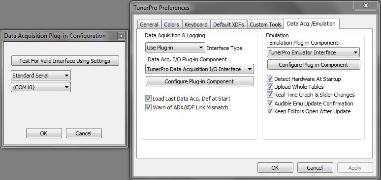

                  I'm considering purchasing the ALDU1 in order to datalog while emulating, to my knowledge it's only 8F that does not emulate and log at the same time and that appears to be a problem with the code not the Autoprom as it emulates and logs A1 and code59 with no problem. What settings do you use in TP5 in order to emulate and log at the same time?

                    Nothing special, I think everything in TP5 in that area is still set to defaults.

                      Okay, I see I'll need to deselect autoprom and switch it to be recognized by TP for emulation so that when data link is pressed it'll recognize ALDU1 instead. Before I make that purchase it looks like I'll be buying a new 6 speed first as my F40 is failing. So much for stronger.

                        I know TunerPro can data log from emulation cable on AutoProm.. on some it seems you can't. But I have never even tried, I just hook up emulation cable and ALDL cable on everything!
