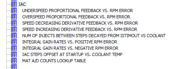

                        I am looking into the IAC adjustments, however I have no idea how to fix these.
                        What are each of the settings in the photo I attached, and how do I understand hwo to adjust these to fix my stalling engine at idle in both open and closed loop?

                          Don't worry about making any IAC adjustments, those are for advanced tuners that know exactly what they are doing and AFTER the engine runs decently. Most of the time those settings NEVER need touched.

                            It finally idles in Drive/Reverse, this was painful to setup. The TGP EPROM code was looking for something the TGP has on it that the beretta harness and ECM does not use or have at all. I somehow got around it. It finally works, but there it the chance to accidentally trigger it and the engine goes full idiot mode and runs full rich, only fix is to shut the engine off when it happens. Only happened once though.

                            I attached my tune to this post.
                            If anyone wants to look at it and let me know how I can improve or fix it further, that would be awesome!

                              if you were to post a log file(XDL), that would be helpful, so other people could see what you're seeing.
