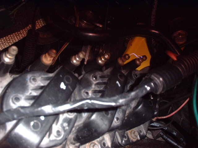

                    Finally I have ignition, the first ignition module was bad so it was scary for a moment. It looks like the 7x ring is doing its job so far as I watched the sparks jump the post pairs starting with 1-4 and moving on down the line. Hopefully tomorrow I'll get it to run.
                    At the moment I'm using the 91 Lumina code to keep things simple, once I get engine fire I'll switch to the 8F code and 2 bar MAP. I have light so I'll start early in the morning because I want to hear the engine run to reward all of my hard work.
