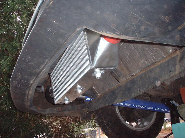

                  I ran out of time again, the little odds and ends wore me out. I did get front mount intercooler circuit completed though. I'm not frustrated since several deficiencies were present that would have set me way back had I driven the car before finding them. While letting the engine idle for about an hour looking for problems, I found an oil leak and the next morning a massive water leak that resulted from a loose clamp and a loose oil sending unit.

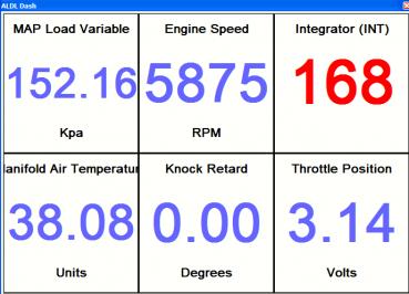

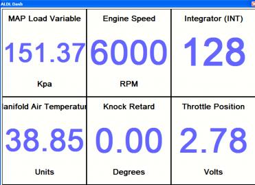

                        The front mount intercooler cut the intake air temps by more than half of previous temps on an 80 degree day as you will see in the screen shots below. Previously the intake temps as you can see above in a previous post were around 100 deg C or 212 deg F at 7 psi, during the test runs the inlet temps reached a maximum of about 42 deg C, 107 deg F, and that was idling in the driveway after the second testdrive. Note the 38 deg C at 7 psi. I'm not taking the car yet because it needs to be tuned. You can see the timing retard due to the lean condition. I expect it to be a little lean up top due to the cam position change and the higher efficiency shift to the right (lower rpm), I wasn't expecting it to be that lean though, good thing I used premium fuel to avoid a serious detonation event.

                          Yes yes yes we all are waiting for some new video.... Getting closer. That intercooler made a HELL of a difference!!! Much better!!!
                          Are the charge pipes going to the FMIC metal or some sort of rubber? having all metal pipes would add more to releasing the heat I would think.

                            There was some concern from members that there would be turbo lag as a result of the intercooler location, after a few acceleration tests I can say not at all, especially when you consider the spool up time changed for the better by the turbos remaining close to the engine and being attached to headers in place of the previous manifolds.
                            There is a rule of thumb stating you can expect a 1% power increase for every 10 deg F the intake air temps drop, so 212 deg F down to the current 100 deg F suggests I gained a 10% power increase plus what the headers have to offer.
                            Even in a poor state of tune where the engine stumbles a bit when launched from idle it was impressive. Once that's ironed out and the methods linked to on stopping wastegate creep linked to under the boost topics is applied it should be even faster on 7 psi.
                            It is very lean in some areas and I attribute that partly to the cam position change and pulling 3 points from the BPC before the test drive. The ~1.5 deg of timing retard that occured under boost was at a high INT reading as can be seen in the screenshots above indicating a very lean spot and also apparently good reserve indicating 10 psi or more should be easily attainable without using my water/meth injection kit.
