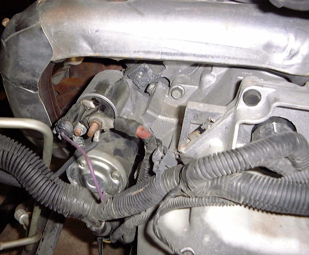

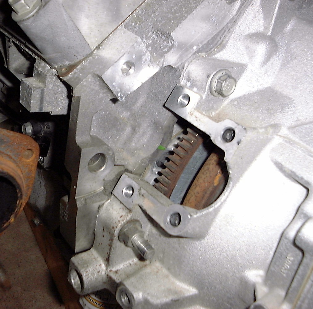

                Not so fast. The starter mounts in the 10 o'clock position to the transmission, not the block...
                Might make things a bit difficult...

                  Nice..
                  I've got plenty of room there.
