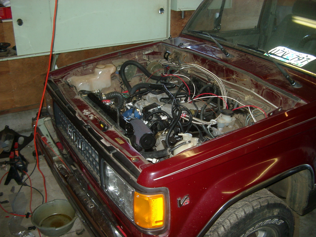

                I am in the process of making my cold air system.
                Well this Weekend I went to my local junkyard looking for a 1980's Caddy with the 4100 engine to get the TBI hat off of it.
                Then I found a rare find that you 60degree car guy's would love to come across it was a 1990 Pontiac Grand Prix turbo charged nothing had been touched on it yet. So I took the intercooler and all the plumbing I left all the exhaust stuff cause I had no use for it.
                I ended up with a wheel barrow load of intake piping,hoses,clamps,and the intercooler for $20.
                I will probly use the intercooler on my GMC because it will fit nice behind my grill and I only use this truck for towing my Travel Trailer and car trailer so I feel I can get the most use out of the intercooler on the GMC.
                Back to the Trooper I went and bought a new cone filter now I have just been thinking how to make the snorkel without water getting to the filter when it rains.
                I have been thinking about not even making a snorkel since I don't plan on going threw anything that will get water inside the cab they just look tuff on a 4x4.I will probly take sheet metal and make my own housing behind the drivers side head lamp.
                Now for the gas milage I am getting around 20mpg. I have found that my tripOD is off atleast 5 miles per 20 miles traveled.
                I have not done the exhaust yet or the cold air so I will be interested in see what difference is made to my MPG.
                Also I feel I have plenty of power to pull the larger tires that is not a concern of mine anymore.

                      Oh hey guys I have some CAI intake solutions for you that I added to my site recently.
                      I have it on my S-10 right now and already bought the parts for my Trooper. The difference is pretty impressive.
